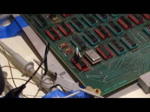

Debugging the disk interface
The photo below shows the disk interface card extended out of the Alto cabinet, with some oscilloscope probes attached to the flip flop chips. (The ribbon cable attached to the board connects to the disk drive, while the ribbon cable hanging above the board allows us to probe microcode signals with the logic analyzer.) Strangely, we didn't see any signals either going into the flip flops or coming out. We checked that the sector pulses were showing up in the logic analyzer, and on the connector from the disk drive, but the flip flops were getting nothing. Eventually we turned our attention to the inverter chip (see earlier schematic). We saw the sector signal going into the inverter, but not coming out. Could this simple chip be causing the problems?
Debugging the disk interface card in the Xerox Alto.
The 7414 TTL chip contains 6 inverters, which turn a 1 input into a 0 output and vice versa. We pulled the chip out of the disk interface board and tested it with a simple LED circuit (see photo below). Five of the six inverters worked fine, but one of the inverters had entirely failed. The chip is a bit unusual since it uses a Schmitt trigger—a circuit that cleans up noisy signals (such as the sector pulses that traveled over a long cable from the disk drive)—so we couldn't get a replacement at Fry's or Radio Shack. Were we stuck for the day?
Testing the 7414 inverter chip from the Xerox Alto's disk interface card. One inverter was burnt out, preventing the disk from working.
Fortunately we could work around the faulty chip. Carl studied the schematics and discovered that one of the good inverters on the chip was unused. We rewired the chip to replace the bad inverter with the unused good inverter by using an ugly but effective "dead bug" hack. We bent out the pins from the good inverter and attached wires. We cut off the pins from the bad inverter. Finally, we stuck the wires into the socket along with the IC, so the good inverter was wired in place of the bad inverter.
We re-wired a 7414 inverter chip. An unused inverter replaced the failed inverter.
We booted the Alto and found that our chip hack actually worked and the system worked much better than before: the sector pulses got through the inverter, were processed by the flip flops, and triggered the sector task as we hoped. The sector task read the disk command from memory and sent it to the disk drive. The disk drive read the desired sector and started sending bits back. For each word, the disk word task read the word from the disk interface and stored it in memory. In summary, we were now reading data from disk!
