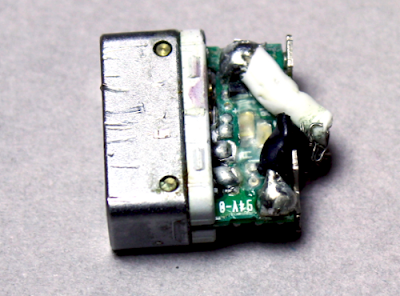

Magsafe connector teardown
I had a Magsafe cable that malfunctioned, burning the power pins as you can see in the photo below, so I figured I'd tear it down and see what's inside. The connector below is an older Magsafe; notice the slightly different shape compared to the Magsafe 2 above. Also note that the middle adapter sense pin is much smaller than the pins, unlike the Magsafe 2. Removing the outer plastic shell reveals a block of soft waxy plastic, maybe polyethylene, that helps diffuse the light from the LEDs and protects the circuit underneath.Cutting through the soft plastic block reveals a circuit board, protected by a thin clear plastic coating. The charger wires are soldered onto the back of this board. Only two wires - power and ground - go to the charger unit. There is no data communication via the adapter sense pin with the charger unit itself.
Disassembling the connector shows the spring-loaded "Pogo pins" that form the physical connection to the Mac. The plastic pieces hold the pins in place. The block of metal on the left is not magnetized, but is attracted by the strong magnet in the Mac's connector.The circuit board inside the Magsafe connector is very small, as you can see below. In the middle are two LEDs, orange/red and green. Two identical LEDs are on the other side. The tiny chip on the left is a DS2413 1-Wire Dual Channel Addressable Switch. This chip has two functions. It switches the status LEDs on and off (that's the "dual channel switch" part). It also provides the ID value to the Mac indicating the charger specifications and serial number.

My macbook 13" T-adaptor plug has been dying for about a year. Often there is no LED (or very dim), even when it is charging OK.
But increasingly it has either not registered as plugged in at all, switching my mac to battery power...... or has registered as plugged in but given me the status of "Not charging, power source : power adaptor".
Previous to this the cable wore out next to the brick, which I repaired. So I assumed the cable had now also worn out next to the LED plug (due to pulling it out of my macbook). Wiggling the cable in this area certainly helped to get the power flowing again (although only temporarily).
But after cutting out 5" segment of cable (which looked fine) the problem persisted, so cleaned the pins on plug and macbook. They weren't dirty, anyway, and it made no difference.
So I then dissected the plug thinking the wires must have come loose from the mini circuit board. Again all looked well, with no obvious heat damage, and they look tightly soldered on. So I didn't touch them.
But I noticed the circuit board moves very slightly allowing a slight gap to appear between it and where the 'pogo pins' connect to it.
One of the pins also fell out (is that supposed to happen?) .... so I put a tiny bit of solder onto the pin and pushed it down its hole again, pushing it with the tip of the soldering iron so it would heat up and (hopefully) solder itself to the circuit board to make a solid connection and stop the wiggling.
It seemed to work OK with the adaptor and LEDs functioning normally too. But when running CPU hungry apps (ones that get the cooling fan running constantly) the plug reverts back to its old problems, cutting out, dim/ blinking LED's and "Battery is not charging" status.

A teardown reveals that the circuit inside is entirely different. Probably, they are using a cheap microcontroller to bit-bang the 1-wire bus on a GPIO pin. I haven't checked the voltage on the zener yet. (With apologies for my terrible drawing:)

The chip in the plug is used to tell the Mac what is going on, but there is a resistor in the Mac that tells the charger what is going on.
