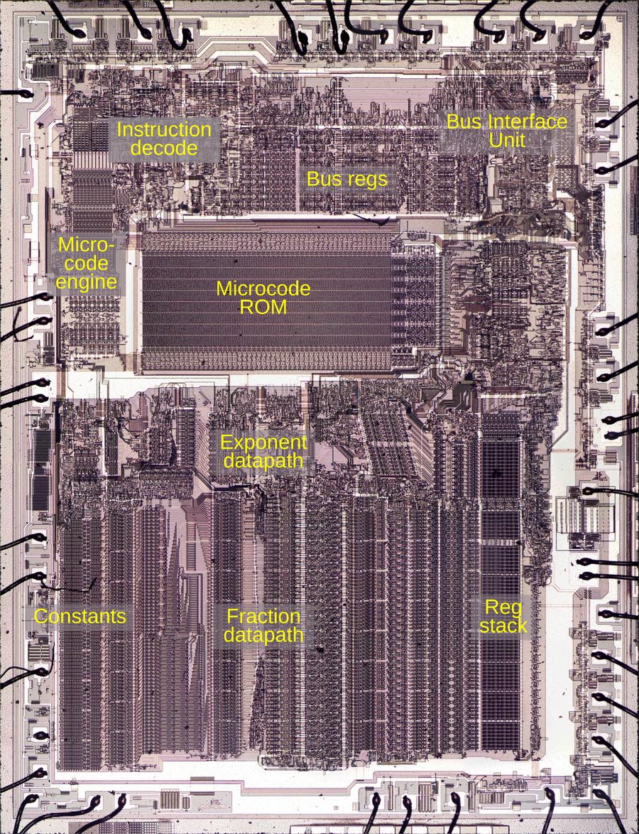

To reverse-engineer the 8087, I chiseled open the ceramic package of an 8087 chip and took numerous photos of the silicon die with a microscope. The complex patterns on the die are formed by its metal wiring, as well as the polysilicon and silicon underneath. The bottom half of the chip is the "datapath", the circuitry that performs calculations on 80-bit floating point values. At the left of the datapath, a constant ROM holds important constants such as π. At the right are the eight registers that the programmer uses to hold floating-point values; in an unusual design decision, these registers are arranged as a stack. Floating-point numbers cover a huge range by representing numbers with a fractional part and an exponent; the 8087 has separate circuitry to process the fractional part and the exponent.
Die of the Intel 8087 floating point unit chip, with main functional blocks labeled. The die is 5 mm×6 mm. Click this image (or any others) for a larger image.
The chip's instructions are defined by the large microcode ROM in the middle.1 To execute an instruction, the 8087 decodes the instruction and the microcode engine starts executing the appropriate micro-instructions from the microcode ROM. In the upper right part of the chip, the Bus Interface Unit (BIU) communicates with the main processor and memory over the computer's bus. For the most part, the BIU and the rest of the chip operate independently, but as we will see, the BIU plays important roles in instruction decoding and execution.

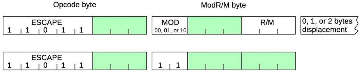

To understand the 8087's instructions, we need to take a closer look at the structure of 8086 instructions. In particular, something called the ModR/M byte is important since all 8087 instructions use it.
The 8086 uses a complex system of opcodes with a mixture of single-byte opcodes, prefix bytes, and longer instructions. About a quarter of the opcodes use a second byte, called ModR/M, that specifies the registers and/or memory address to use through a complicated encoding. For instance, the memory address can be computed by adding the BX and SI registers, or from the BP register plus a two-byte offset. The first two bits of the ModR/M byte are the "MOD" bits. For a memory access, the MOD bits indicate how many address displacement bytes follow the ModR/M byte (0, 1, or 2), while the "R/M" bits specify how the address is computed. A MOD value of 3, however, indicates that the instruction operates on registers and does not access memory.
Structure of an 8087 instruction
The diagram above shows how an 8087 instruction consists of an ESCAPE opcode, followed by a ModR/M byte. An ESCAPE opcode is indicated by the special bit pattern 11011, leaving three bits (green) available in the first byte to specify the type of 8087 instruction. As mentioned above, the ModR/M byte has two forms. The first form performs a memory access; it has MOD bits of 00,01, or 10 and the R/M bits specify how the memory address is computed. This leaves three bits (green) to specify the address. The second form operates internally, without a memory access; it has MOD bits of 11. Since the R/M bits aren't used in the second form, six bits (green) are available in the R/M byte to specify the instruction.

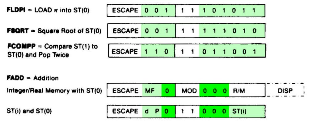

The challenge for the designers of the 8087 was to fit all the instructions into the available bits in such a way that decoding is straightforward. The diagram below shows a few 8087 instructions, illustrating how they achieve this. The first three instructions operate internally, so they have MOD bits of 11; the green bits specify the particular instruction. Addition is more complicated because it can act on memory (first format) or registers (second format), depending on the MOD bits. The four bits highlighted in bright green (0000) are the same for all ADD instructions; the subtract, multiplication, and division instructions use the same structure but have different values for the dark green bits. For instance, 0001 indicates multiplication and 0100 indicates subtraction. The other green bits (MF, d, and P) select variants of the addition instruction, changing the data format, direction, and popping the stack at the end. The last three bits select the R/M addressing mode for a memory operation, or the stack register ST(i) for a register operation.
The bit patterns for some 8087 instructions. Based on the datasheet.

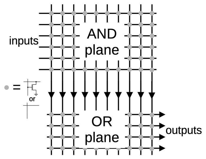

Processors often use a circuit called a PLA (Programmable Logic Array) as part of instruction decoding. The idea of a PLA is to provide a dense and flexible way of implementing arbitrary logic functions. Any Boolean logic function can be expressed as a "sum-of-products", a collection of AND terms (products) that are OR'd together (summed). A PLA has a block of circuitry called the AND plane that generates the desired sum terms. The outputs of the AND plane are fed into a second block, the OR plane, which ORs the terms together. Physically, a PLA is implemented as a grid, where each spot in the grid can either have a transistor or not. By changing the transistor pattern, the PLA implements the desired function.
A simplified diagram of a PLA.
A PLA can implement arbitrary logic, but in the 8087, PLAs often act as optimized ROMs.4 The AND plane matches bit patterns,5 selecting an entry from the OR plane, which holds the output values, the micro-address for each routine. The advantage of the PLA over a standard ROM is that one output column can be used for many different inputs, reducing the size.

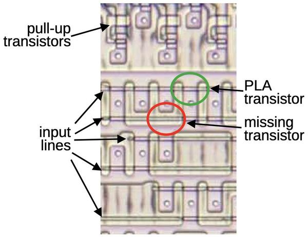

The image below shows part of the instruction decoding PLA.6 The horizontal input lines are polysilicon wires on top of the silicon. The pinkish regions are doped silicon. When polysilicon crosses doped silicon, it creates a transistor (green). Where there is a gap in the doped silicon, there is no transistor (red). (The output wires run vertically, but are not visible here; I dissolved the metal layer to show the silicon underneath.) If a polysilicon line is energized, it turns on all the transistors in its row, pulling the associated output columns to ground. (If no transistors are turned on, the pull-up transistor pulls the output high.) Thus, the pattern of doped silicon regions creates a grid of transistors in the PLA that implements the desired logic function.7
Part of the PLA for instruction decoding.
The standard way to decode instructions with a PLA is to take the instruction bits (and their complements) as inputs. The PLA can then pattern-match against bit patterns in the instruction. However, the 8087 also uses some pre-processing to reduce the size of the PLA. For instance, the MOD bits are processed to generate a signal if the bits are 0, 1, or 2 (i.e. a memory operation) and a second signal if the bits are 3 (i.e. a register operation). This allows the 0, 1, and 2 cases to be handled by a single PLA pattern. Another signal indicates that the top bits are 001 111xxxxx; this indicates that the R/M field takes part in instruction selection.8 Sometimes a PLA output is fed back in as an input, so a decoded group of instructions can be excluded from another group. These techniques all reduce the size of the PLA at the cost of some additional logic gates.
The result of the instruction decoding PLA's AND plane is 22 signals, where each signal corresponds to an instruction or group of instructions with a shared microcode entry point. The lower part of the instruction decoding PLA acts as a ROM that holds the 22 microcode entry points and provides the selected one.9

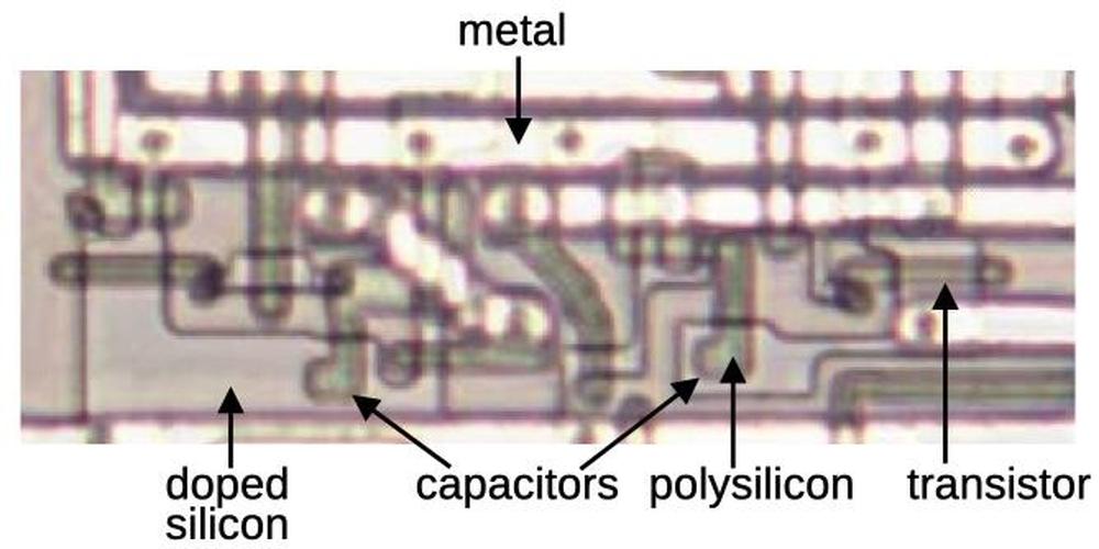

  13. I'll give more details here on the circuit that jumps to the save or restore microcode. The BIU sends two signals to the microcode engine, one to jump to the save code and one to jump to the restore code. These signals are buffered and delayed by a capacitor, probably to adjust the timing of the signal.
    In the microcode engine, there are two hardcoded constants for the routines, just above the jump table; the BIU signal causes the appropriate constant to go onto the micro-address lines. Each bit in the address has a pull-up transistor to +5V or a pull-down transistor to ground. This approach is somewhat inefficient since it requires two transistor sites per bit. In comparison, the jump address ROM and the instruction address ROM use one transistor site per bit. (As in a PLA, each transistor is present or absent as needed, so the number of physical transistors is less than the number of transistor sites.)
    Two capacitors in the 8087. This photo shows the metal layer with the silicon and polysilicon underneath.
    Since capacitors are somewhat unusual in NMOS circuits, I'll show them in the photo above. If a polysilicon line crosses over doped silicon, it creates a transistor. However, if a polysilicon region sits on top of the doped silicon without crossing it, it forms a capacitor instead. (The capacitance exists for a transistor, too, but the gate capacitance is generally unwanted.) ↩
