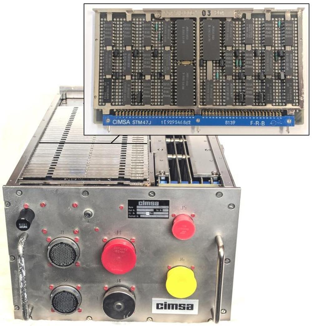

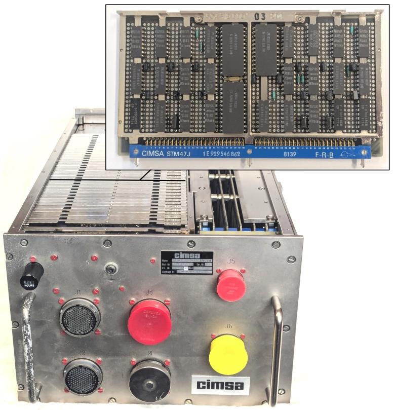

The Mitra 125 MS computer, built by CIMSA, with one of the ALU/register cards shown.

Because Spacelab was a European project, it used a European computer, the Mitra 125 MS. The Mitra line started in 1971 when a French company called CII introduced the Mitra 15 minicomputer, a 16-bit computer that used magnetic core memory. Mitra is a French acronym2 that translates as "Mini-machine for Real-Time and Automatic Computing." As the name suggests, Mitra was both small and designed for real-time computing, making it suitable for controlling experiments. The Mitra 15 was a popular computer, with almost 8000 units sold.
In 1975, CII produced a successor called the Mitra 125. The Mitra 125 improved on the Mitra 15 by adding memory management, I/O processors, higher performance, and additional instructions. Spacelab used the Mitra 125 MS minicomputer,3 a militarized variant of the Mitra 125 that was produced by a company called CIMSA. A Spacelab mission had three of these computers: the Subsystem Computer controlled and managed Spacelab itself, while the Experiment Computer handled the experiments. A Backup Computer could take over if either computer failed.1 These computers were part of Spacelab's Command and Data Management Subsystem, which controlled experiments and collected data.4

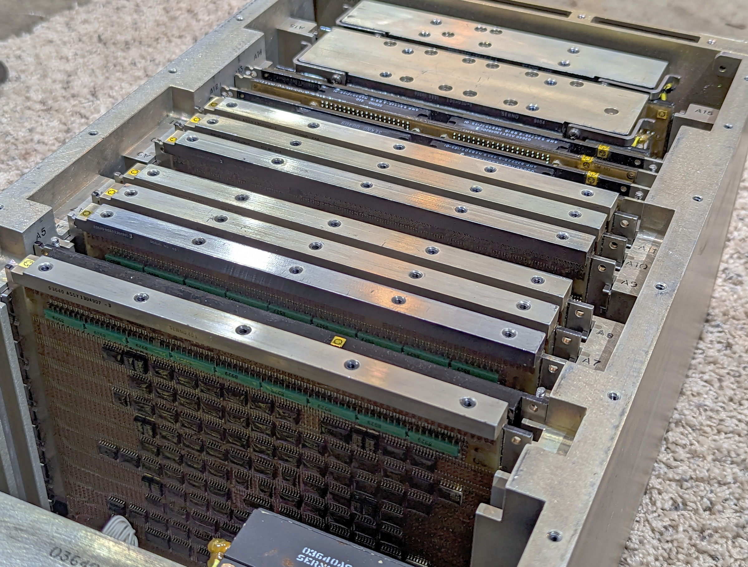

The Mitra's ALU/register boards
The Spacelab computer used eight '181 ALU chips to implement a 32-bit adder.6 (Specifically, these chips are the 54S181, a variant of the 74181: "54" indicates that the chips handle the military temperature range, and "S" indicates that the chip is built from high-speed Schottky logic.) However, the ALU boards required numerous additional chips. Depending on the instruction, eight different inputs could be selected for the ALU. Chips called multiplexers selected the desired value, requiring 32 multiplexer chips. Three 32-bit registers provided storage for ALU inputs and outputs, requiring 24 chips. Two 54S182 carry-lookahead chips provided fast carry computation. Finally, some simple logic chips (inverters and NAND gates) tied things together.

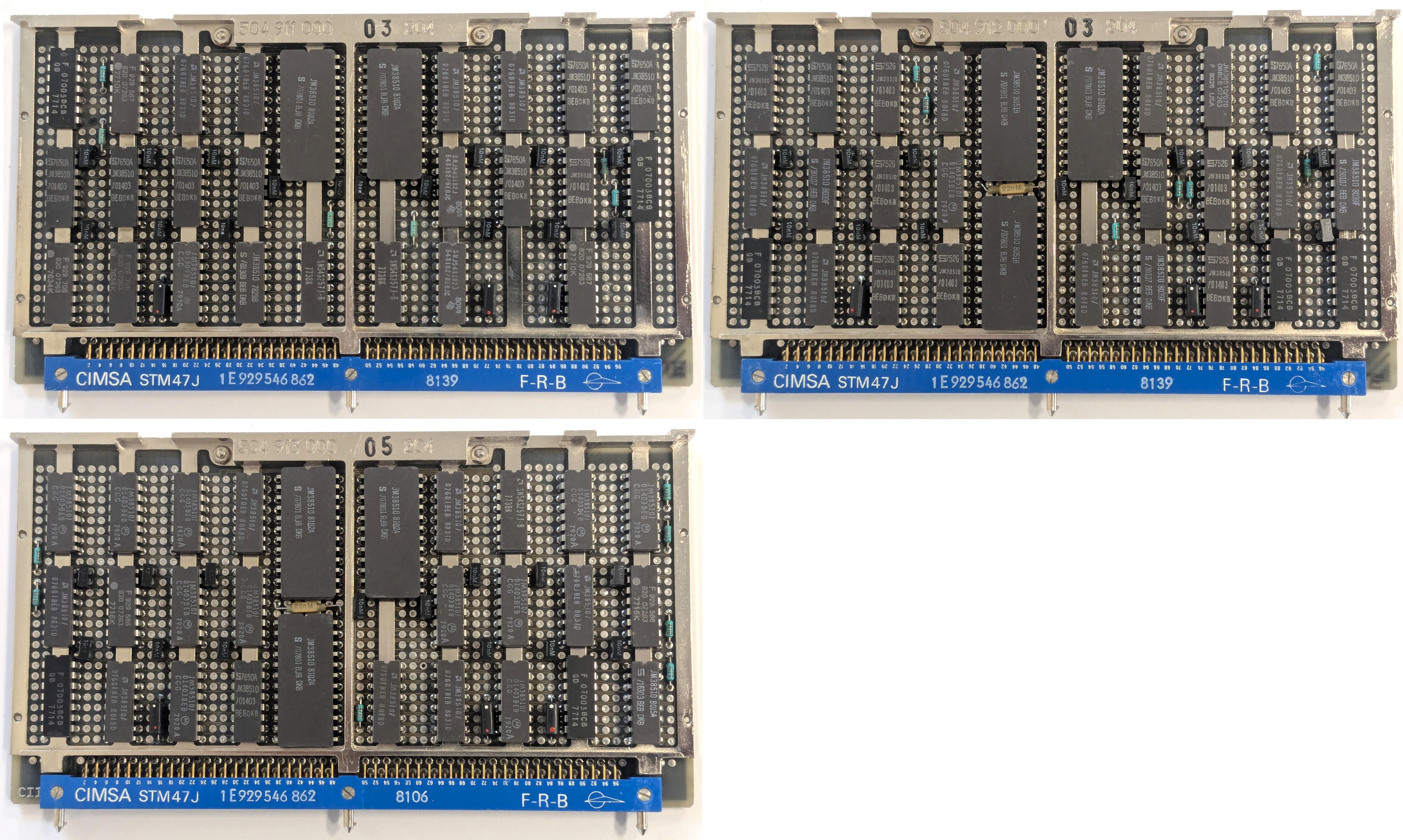

Due to the number of chips required, the ALU/register circuitry was spread across three boards, as shown below. (I reverse-engineered the board on the right.7) The '181 chips are immediately visible as they are much larger than the other chips; they have 24 pins, compared to 14 or 16 pins for the other chips. The first board has two '181 chips, while the last two boards each have three '181 chips. The last two boards are similar, but not identical.
The three ALU/register boards from the Spacelab computer.
Click this image (or any other) for a larger version.
The three ALU/register boards from the Spacelab computer. Click this image (or any other) for a larger version.

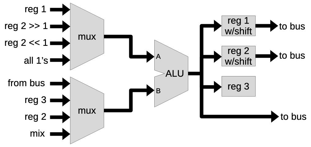

Finding a 32-bit ALU was a surprise to me, since the computer is a 16-bit computer. The expanded ALU was probably implemented to improve performance. Multiplying two 16-bit numbers yields a 32-bit result, so a 32-bit ALU makes multiplication faster. Moreover, the computer supports 32-bit floating-point numbers, so the 32-bit ALU presumably makes floating-point operations faster.
The diagram below shows the architecture of the computer's 32-bit ALU system. In the middle is the ALU itself, operating on two 32-bit operands: A and B. At the left, multiplexers ("mux") select one of four values for A and one of four values for B. At the right, the output of the ALU can be stored in three 32-bit registers, or sent to the rest of the computer via the bus. The first two registers are shift registers, allowing the value to be shifted left or right, while the third register simply holds the value in flip-flops. The first two registers are connected by buses to the rest of the computer, while the value of the third register can only be accessed by using it for another arithmetic operation.8 I suspect that the shift registers are used for multiplication and division to shift the arguments at each step.
Block diagram of the ALU/register board.
The inputs to the multiplexers provide flexibility. For instance, you can add register 1 to a number from the bus, or add register 2 shifted to the right to register 3. (Note that this shifting is implemented by wiring the inputs to the multiplexer shifted left or right, completely separate from the shift register's shifting.) The "all 1's" input is either a zero input (with negative logic), or -1 (in two's-complement). The B input can be taken from the bus, allowing the value to come from memory or from a general-purpose register. The mix input is a jumble of signal lines, register bits, a shift register input, and a pull-up with no apparent pattern. I describe a few more mysteries in the footnote;9 presumably, the mysteries would be resolved if I reverse-engineered the whole computer.
The functions of the multiplexers, ALU chips, and registers depend on what instruction is being executed. Specifically, the computer's microcode engine generates control signals for the computer, including the ALU/register boards. Some of these control signals select which multiplexer inputs are used. Other control signals select the ALU's function. Finally, control signals select which register receives the ALU's output.

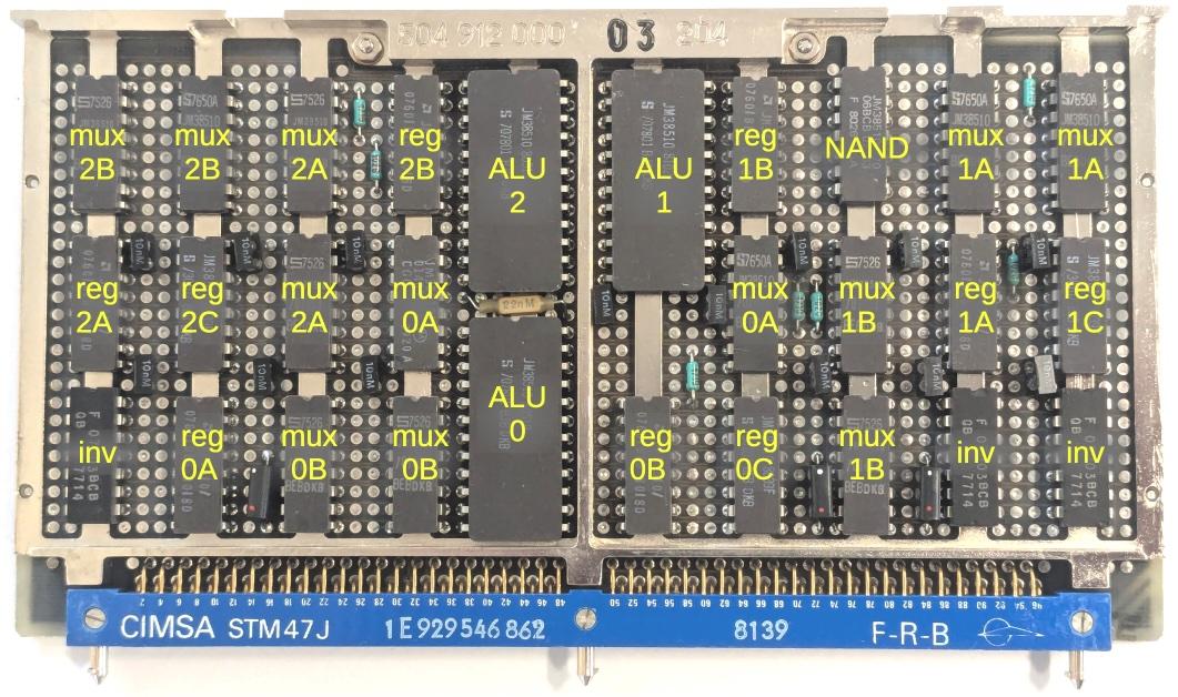

The board that I reverse engineered implements 12 of the 32 bits of the ALU and registers. The image below shows the role of each chip on the board. The three 4-bit ALU chips are indicated 2, 1, and 0. Each ALU chip has two multiplexer chips to select the four A input bits and two multiplexer chips to select the four B input bits.10 Thus, there are 12 multiplexer chips on the board. The three 12-bit registers A, B, and C are each implemented with three 4-bit chips. Three hex inverter chips and a 4-input NAND chip complete the board.11
The ALU/register board with the chips labeled.

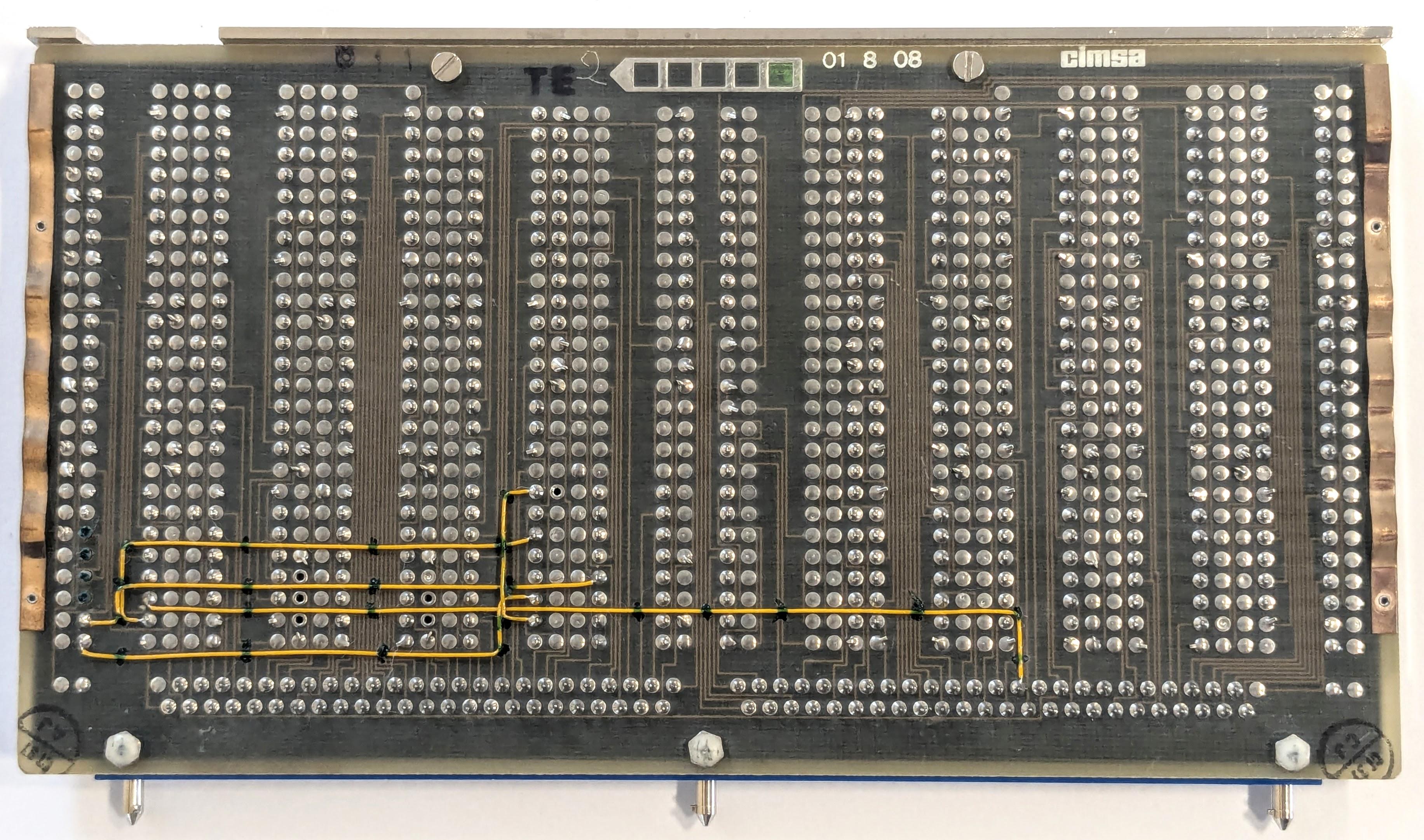

These printed-circuit boards (PCBs) have some interesting features. In most electronics, circuit boards have holes only where they are needed, but the Spacelab boards have holes in a fixed grid pattern. (IBM used similar boards in its System/360 computers in the 1960s.12) A hole can hold an IC pin or other component. Or a hole can be used as a via, connecting PCB traces on different layers. Another interesting feature of the boards is the vertical metal bars underneath the integrated circuits. These bars carry heat away from the integrated circuits.
The PCB traces are more visible on the back of the board (below). The traces are thin enough that two traces can pass between a pair of holes. Note the yellow "bodge" wires, correcting errors on the circuit board. I assume that these errors were fixed for the computers used in flight.
Back of an ALU/register board. This is a different board from the one I reverse engineered, since I wanted to show the yellow wires.

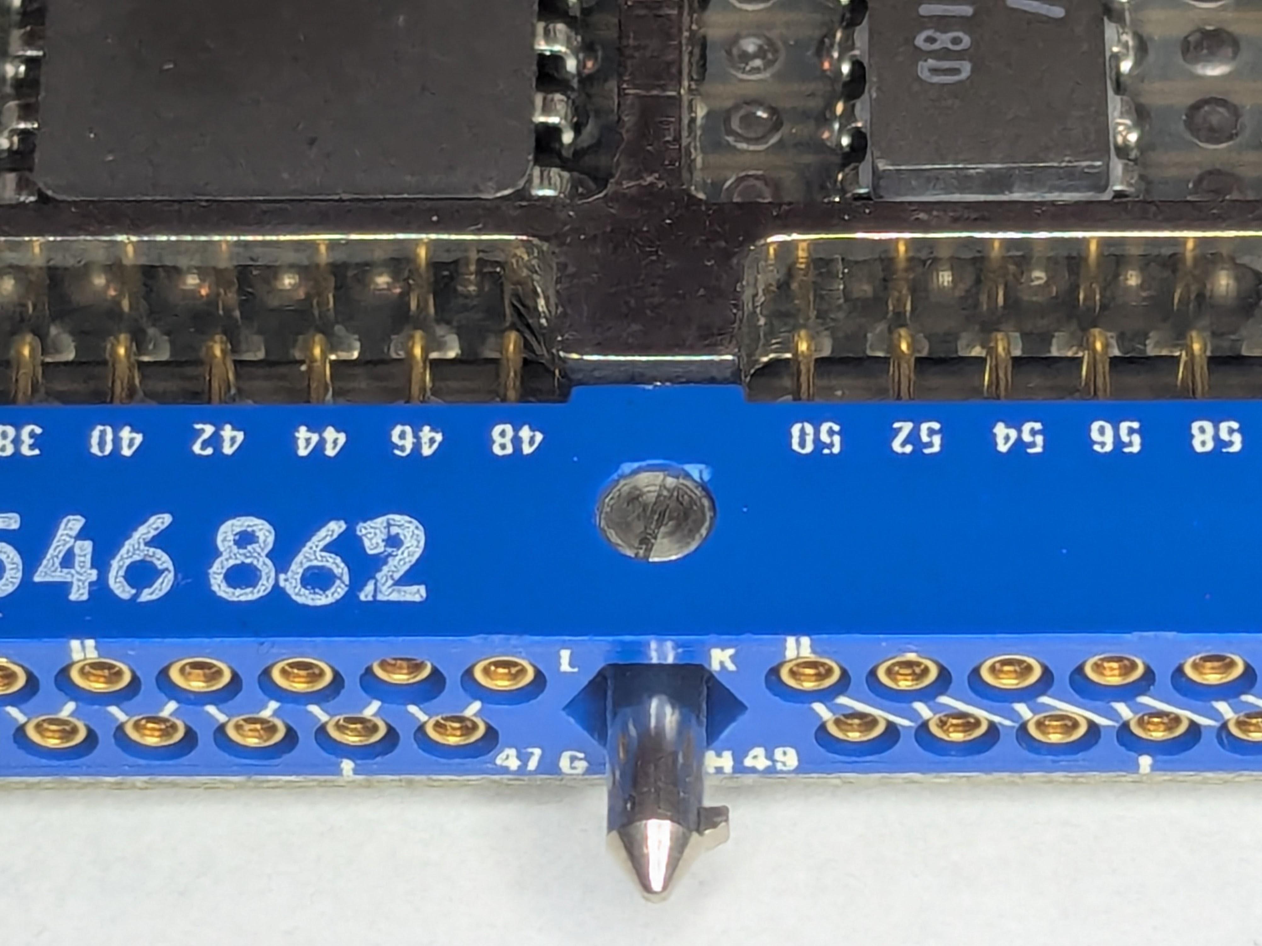

Each board has a 96-pin connector at the bottom, which plugs into the computer's motherboard. Note the three cylindrical pins sticking out of the connector. These pins are keyed to ensure that a board can only be plugged into the correct slot. That is, each pin has a metal tab oriented in one of six directions. On the motherboard, the connectors have corresponding notches. If the tabs and the notches don't match up, the board can't be plugged in.
A close-up of the connector, showing the keying. Also note that the zig-zag pin numbering on the left changes to an irregular number on the right. Unexpectedly, pin 52 is between pins 49 and 51, for example,
The boards in the Spacelab computer are dense, tightly packing integrated circuits to minimize the size of the computer. However, the boards are considerably less dense than American aerospace computers. In particular, the Spacelab computer used the same integrated circuit packages that were used in consumer electronics: through-hole DIPs (dual in-line packages with two rows of pins). In contrast, IBM's line of 4 Pi aerospace computers used "flat-pack" integrated circuits that were considerably smaller and thinner (details). As a result, IBM's double-sided circuit boards could hold 156 integrated circuits compared to 30 on a single-sided Mitra board of roughly the same size.

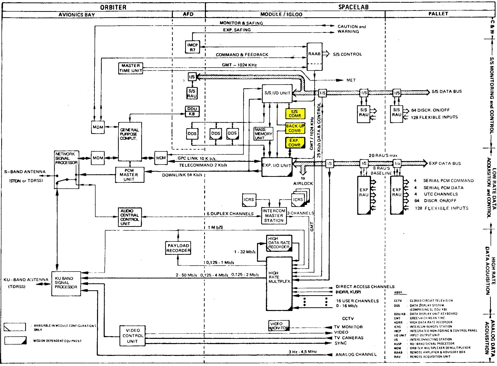

  4. Spacelab's Command and Data Management Subsystem (CDMS) is surprisingly complicated because of the data communication paths between Spacelab, the Shuttle, and the ground. Moreover, multiple units store, encode, and decode data. In the CDMS block diagram below, I've highlighted the three computers; they are just a small part of the CDMS. See Section 3.5 of Spacelab News Reference or The Command and Data Management System of Spacelab for details on CDMS.
    A block diagram of Spacelab's Command and Data Management Subsystem. From The Command and Data Management System of Spacelab. Click for a larger version.

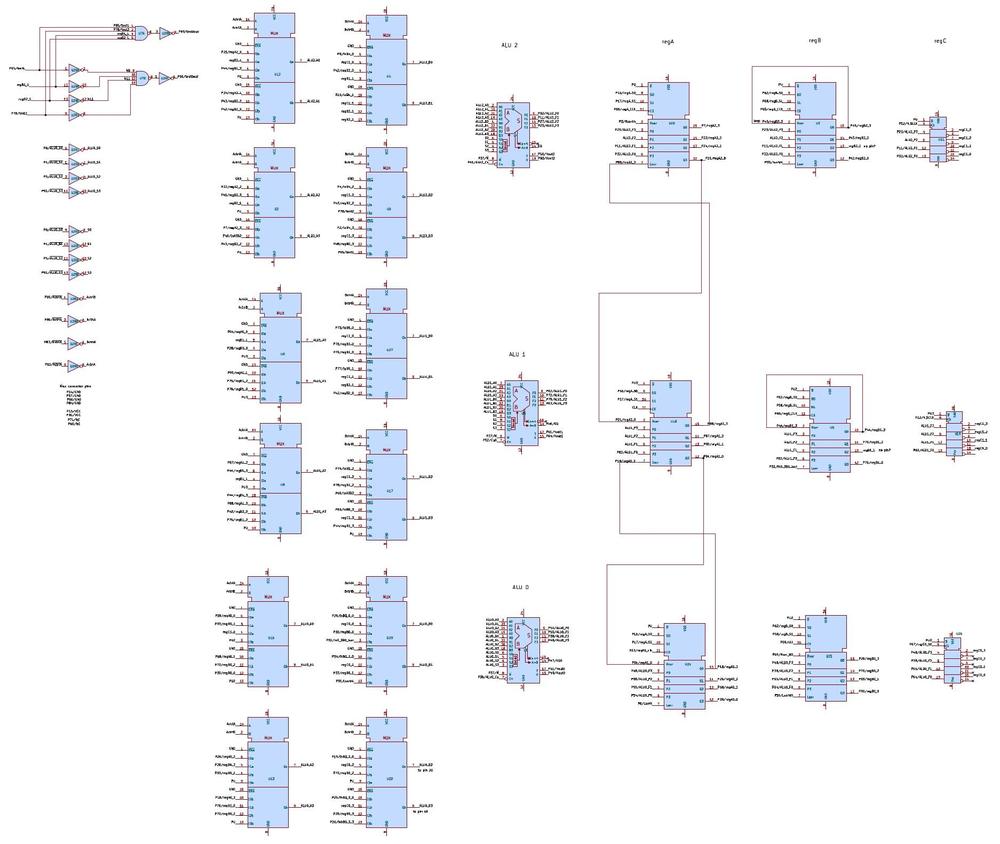

  7. My reverse-engineering process was straightforward but tedious. I used a multimeter to beep out the connections between the integrated circuits as well as the connections to the connector. (Unlike many systems that I look at, these boards didn't have conformal coating, which made beeping out the connections practical.) I created a schematic in KiCad from this data; this schematic was "physical", with the layout of the chips and pins matching their physical location on the board. Next, I converted the integrated circuit symbols from physical rectangles to logical symbols. Finally, I moved the symbols around on the schematic to make a reasonable schematic. (I had to go back and beep out more connections as I discovered errors or missing connections.) Theoretically, I could reverse-engineer the entire computer, but reverse-engineering one of the 36 boards is enough for me. ↩
  8. My full reverse-engineered schematic of the ALU/register board is below. Click for a larger version.
    Schematic of the ALU/register board.
  9. A few mysteries remain in the ALU/register board. The three registers probably act as an accumulator, a temporary register, and an extra register for multiplication/division, but it's not clear which register is which. I don't understand why the inputs are organized as they are; for instance, you can't add register 1 to register 2 shifted. The mix input seems very random; maybe these signals are part of a self test? On the board, I expected to see 12 bits out of a uniform 32-bit ALU. However, the top two 4-bit "nibbles" have different control lines and different zero-detection from the third. Perhaps this is because the Mitra floating-point numbers have 24 bits of mantissa and 8 bits of exponent. It would make sense for the ALU/register board to handle these parts separately. Another mystery is that the board has a circuit to test two hardwired bits and two external bits to see if they are all 0 or all 1, for some reason. ↩
  10. The multiplexer chips are dual 4-to-1 multiplexers. Thus, two multiplexer chips are required to support four bits. ↩

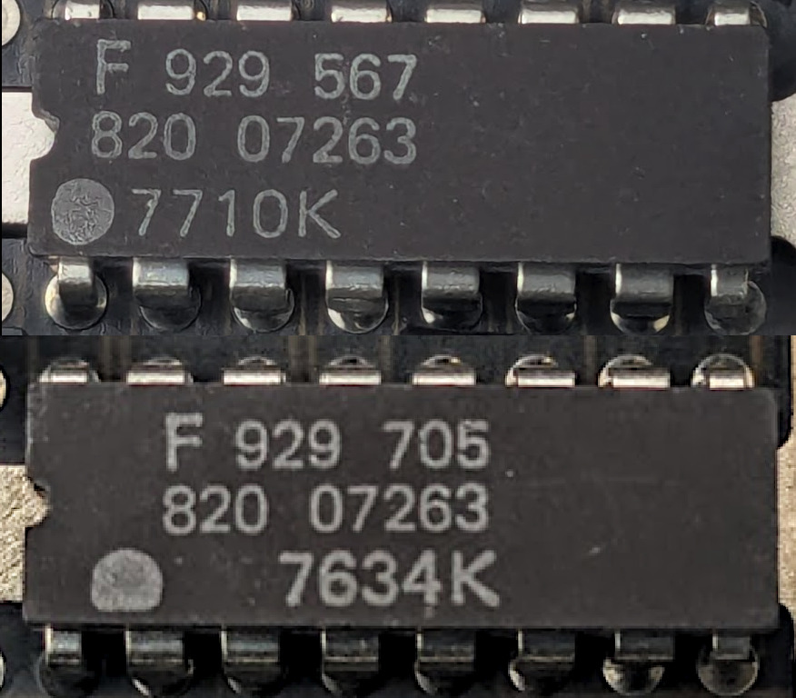

  11. The chips in the Spacelab computer use a variety of part number systems. A few chips have standard industry part numbers such as "SNJ5483" (equivalent to a 7483 adder). Most of the chips are labeled with military part numbers such as JM38510/07801 BJB, using the MIL-M-38510 standard. These part numbers can be cross-referenced using the MIL-HDBK-983 handbook. Other chips, like the ones below, have Fairchild part numbers that are a mystery to me. The first line is presumably the part number, "929 567" and "929 705", but I can't find these numbers anywhere. If you know what these numbers mean, please let me know! (07263 is the CAGE code for Fairchild, and the last line is the date code.)
    Two Fairchild ICs with mysterious part numbers.
    The ALU/register board that I examined uses the following JM38510 part numbers, which I have converted to standard parts:
    /01403 = 54153 dual 4-1 multiplexer
    /07003 = 54S04 hex inverter
    /07006 = 54S20 4-input NAND
    /07601 = 54S194 4-bit shift register
    /07801 = 54S1814-bit ALU
    /30107 = 54LS175 quad flip-flop ↩

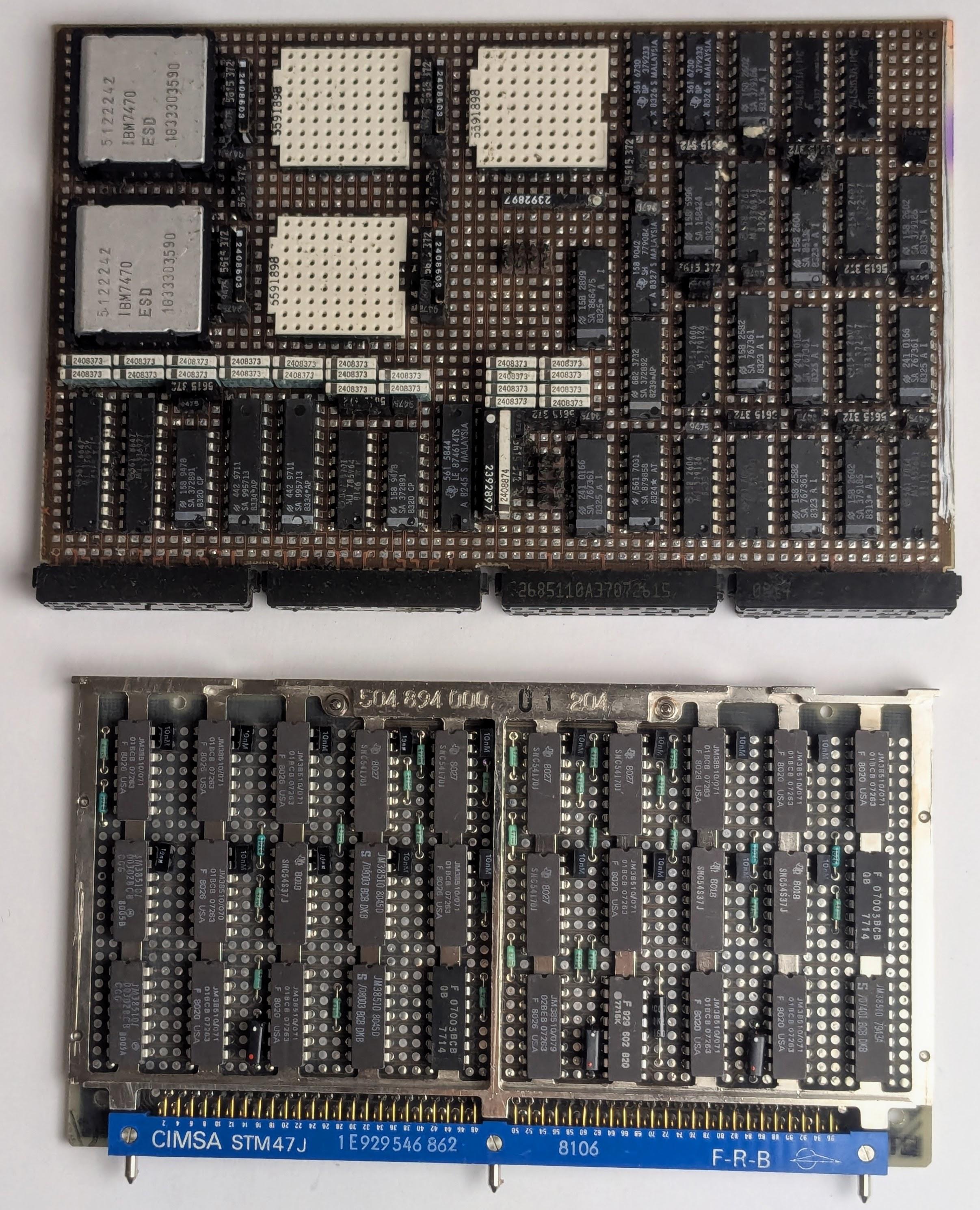

  12. The photo below compares an IBM board (top) with a Spacelab board (bottom), both from the early 1980s. It's interesting how similar the boards are. Both use a 0.1" grid of holes, unlike most printed-circuit boards, which only use holes where needed. Both boards are multi-layer with integrated circuits on one side. The IBM board is denser; the chips are spaced 0.1" apart rather than 0.3" apart.
    An IBM computer board (top) and a board from the Spacelab computer (bottom).
    I don't know which IBM system used this board, but it was a commercial system, not an aerospace system. This board is a bit unusual for IBM, since most of the chips are standard DIPs rather than the square metal cans that IBM typically used. ↩
