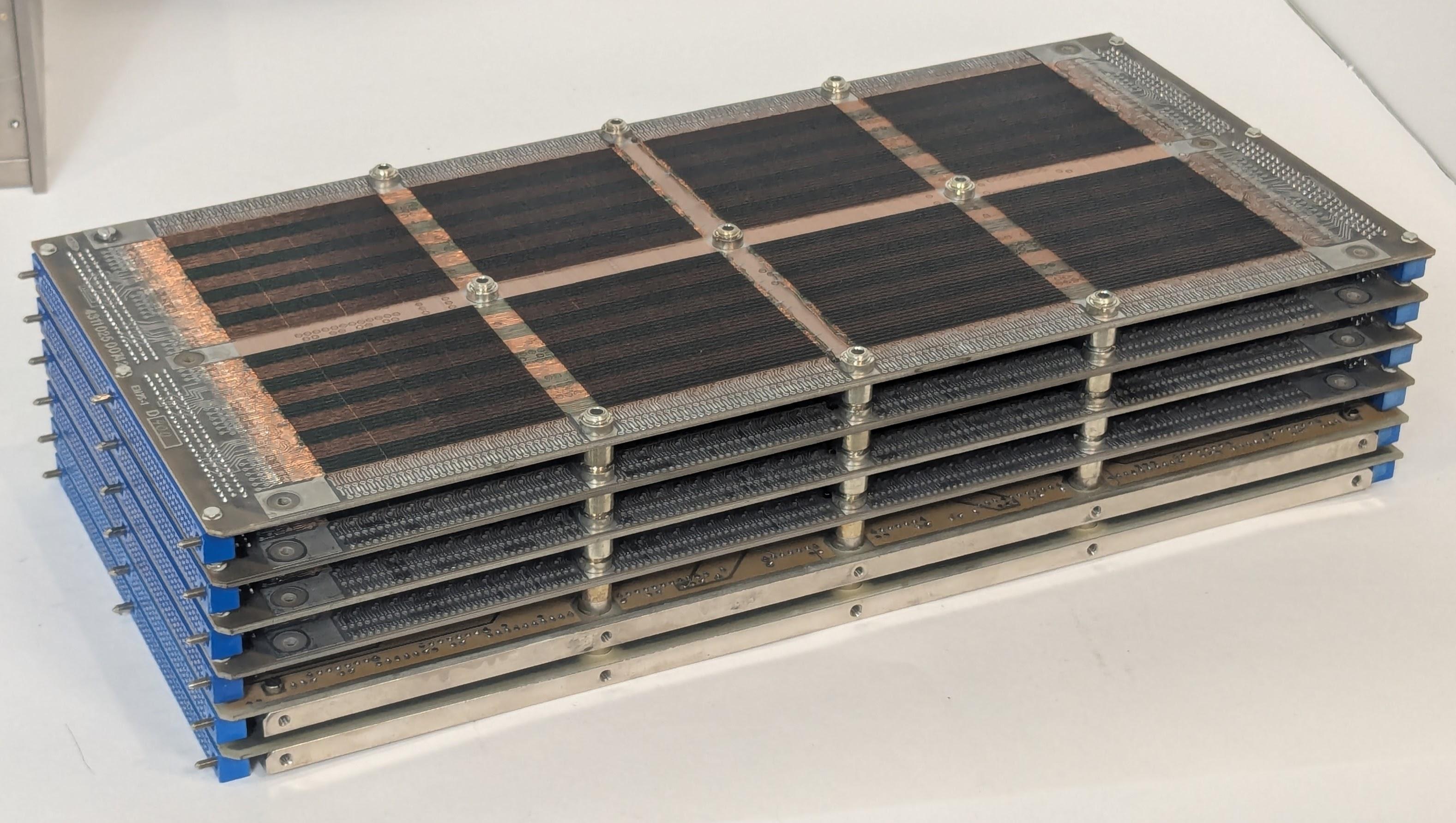

The core stack from the Spacelab computer. I removed the top board to show the core planes.

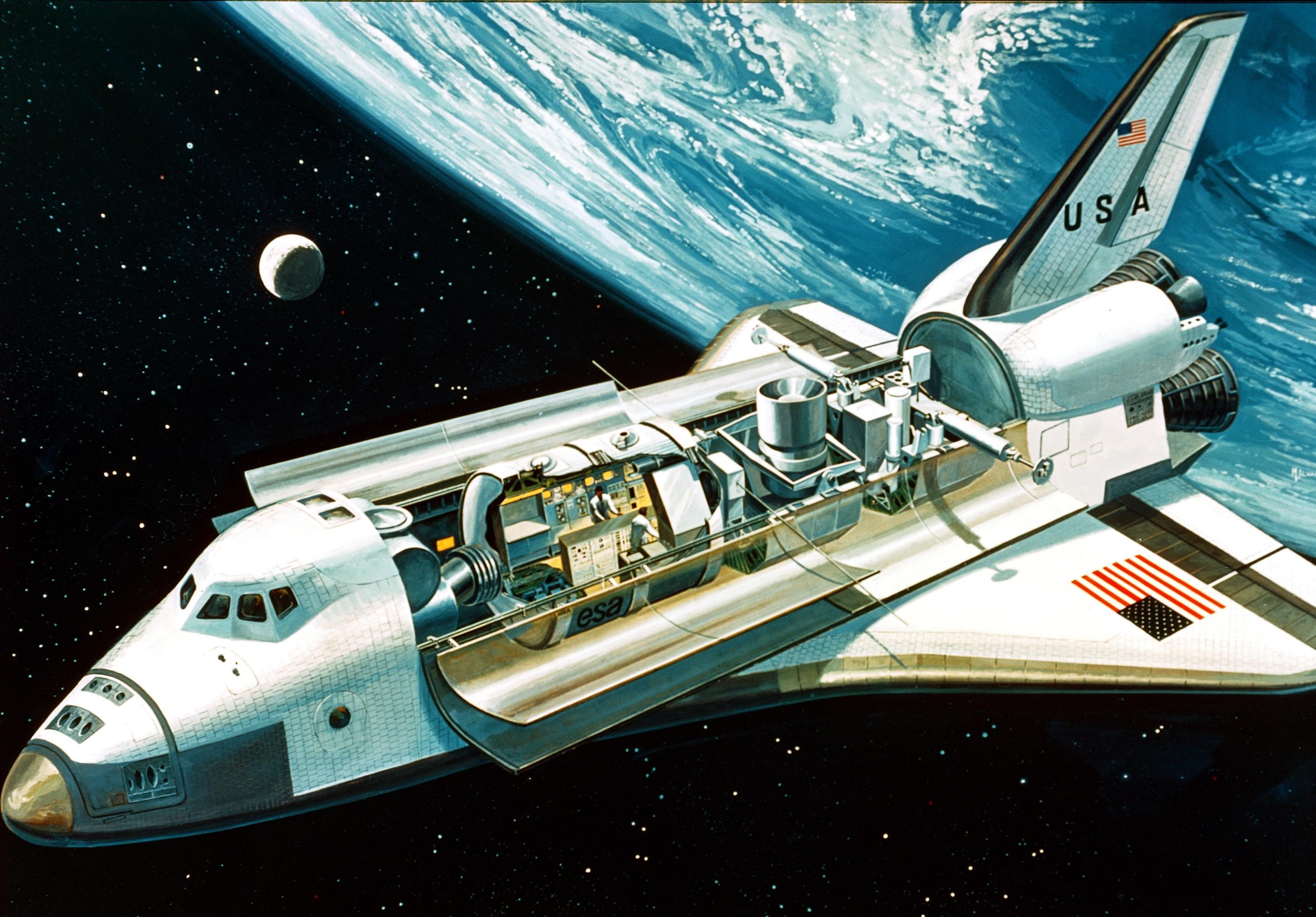

The illustration below shows how Spacelab fit inside the Shuttle's cargo bay. The pressurized laboratory is the cylindrical module in the front of the cargo bay, connected to the Shuttle by a tunnel. Experiments were mounted on pallets behind the laboratory. The laboratory held three identical Mitra computers.3 One computer managed Spacelab itself, while the second computer managed the experiments. The third computer provided a backup in case of failures.
Spacelab was a pressurized cylinder in the Shuttle's cargo bay, connected to the Shuttle by a tunnel. It provided a laboratory for researchers to perform experiments. This illustration of Spacelab is from NASA, C-1976-4380.

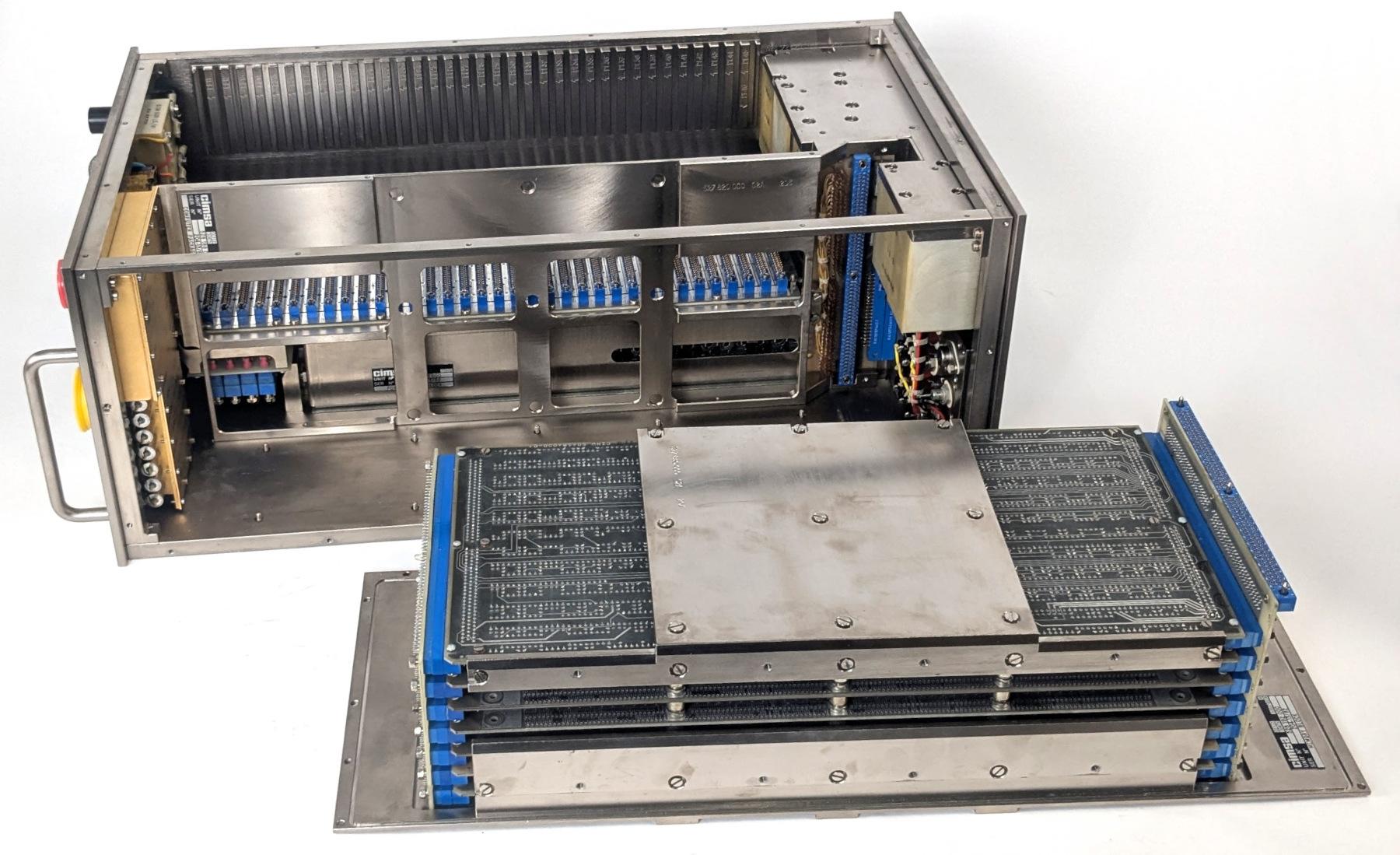

The photo below shows the core memory stack, removed from the computer. The core memory stack takes up roughly a third of the computer. The entire side panel of the computer detaches, and the core memory unit slides out. Since the computer is cooled by conduction, firmly attaching the core memory stack to the side panel kept it cool. The core memory stack consists of seven boards: a driver board, four core plane boards, a second driver board, and an interface board. Each board has two 160-pin connectors that plug into a large daughter board on each side, providing extensive connectivity between the boards. The daughter board on the right has another 160-pin connector that links the memory stack to the rest of the computer. (These connectors are the long blue connectors in the photo.)
The core memory stack in front of the Mitra computer. The circuit boards have been removed from the far side of the computer.

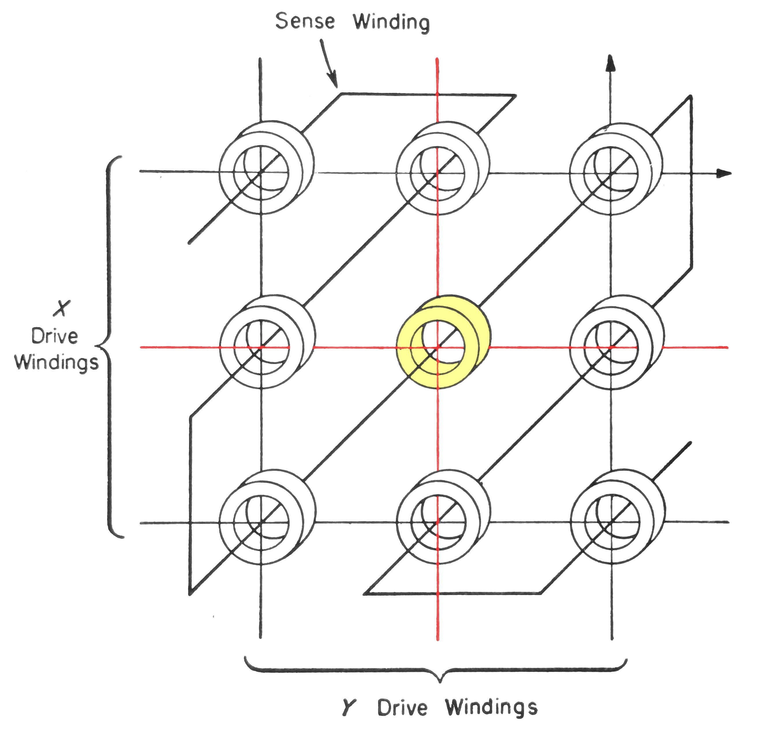

Core memory is based around a tiny toroidal magnetic core, one per bit.4 A core can be magnetized clockwise or counterclockwise to store a bit. The core can be magnetized by threading a wire through the core: running a current through the wire produces a magnetic field that magnetizes the core, while running a current in the opposite direction produces the opposite magnetization.
A key problem with core memory was how to wire the cores without an absurd number of wires: if each core had a separate wire, just 16 KB of storage would require over 100,000 wires. The solution was called "coincident current addressing". The cores are arranged in a grid, with horizontal and vertical wires, as shown below. By running a current through one horizontal wire and one vertical wire, the single core at the intersection was selected. But wouldn't that magnetize all the cores along the horizontal and vertical wires? The key was that the cores were constructed from special magnetic materials with a property called hysteresis: a small current leaves the core completely unchanged, while a larger current flips the core's magnetic state. The currents through the horizontal and vertical wires were carefully selected so each wire had half the current necessary to flip the core; where the wires intersected, the two currents provided sufficient magnetic field to flip the core.
Energizing an X drive wire and a Y drive wire selects one core, highlighted in yellow. Diagram adapted from Digital Computer Components and Circuits, R. K. Richards, p355
The next step was reading the core. A sense wire was threaded through all the cores in the two-dimensional plane. To read a core, the X and Y select wires were driven to flip the desired core to the 0 state. If the core was already in the 0 state, nothing happened. But if the core was originally in the 1 state, the magnetic field changed as the core changed state. This induced a small current in the sense line, indicating that the core held a 1. Note that reading the value of a bit destroys that value. Thus, a core needs to be rewritten after reading, to restore the original data.

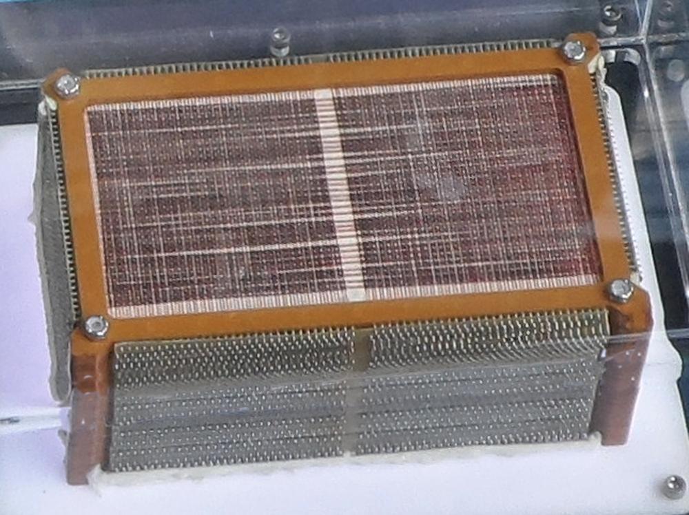

To access a word of memory at a time, core planes were combined into a three-dimensional stack (below). Since each plane held one bit of the word, a 16-bit word would have a stack of 16 planes. All the planes shared the signals to drive the X and Y lines, so a one-word column through the stack was accessed in parallel. Each plane had a separate sense line to read out the bit.
The core stack from the Saturn V LVDC (Launch Vehicle Digital Computer) consists of 14 core planes. This stack is at the US Space & Rocket Center. Photo from NCAR EOL. I retouched the photo to reduce distortion from the plastic case.

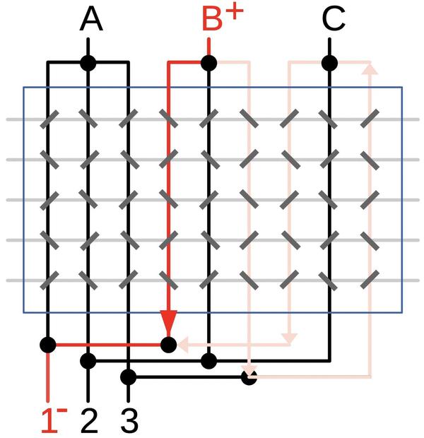

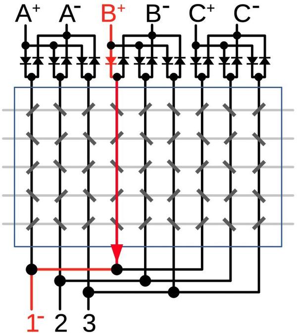

Illustration of how "top" and "bottom" drivers work together to select a single line (red) through the core matrix. However, current can take alternate paths, such as the pink path.

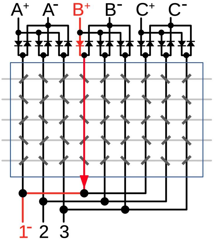

Unfortunately, it's not quite that easy. Current can take "sneak paths" through the cores, such as the path in pink above. The solution is to add diodes to ensure that current can't take the wrong path. Since a wire needs to be driven with currents in both directions (to flip cores both ways), two diodes are required on each wire, as shown below, one in each direction. Each matrix input (A, B, etc.) is replaced with two inputs, one to drive each direction. (The horizontal wires also require diodes, not shown.)
Adding diodes ensures that current only takes the desired path.

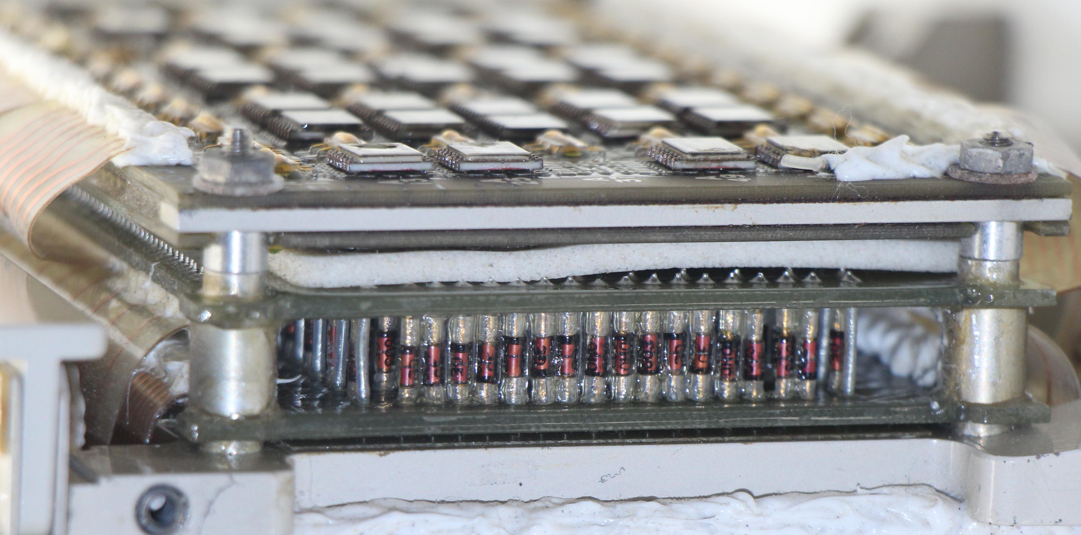

Since each wire requires two diodes, core memories used many diodes. Fortunately, diodes were small and inexpensive, so a large quantity of diodes was manageable. The photo below shows the diode stack for the computer used in the Saturn V rocket, the Launch Vehicle Digital Computer.
Closeup of the diode matrix in the Saturn V LVDC. Diodes are mounted vertically using cordwood construction between two printed circuit boards.

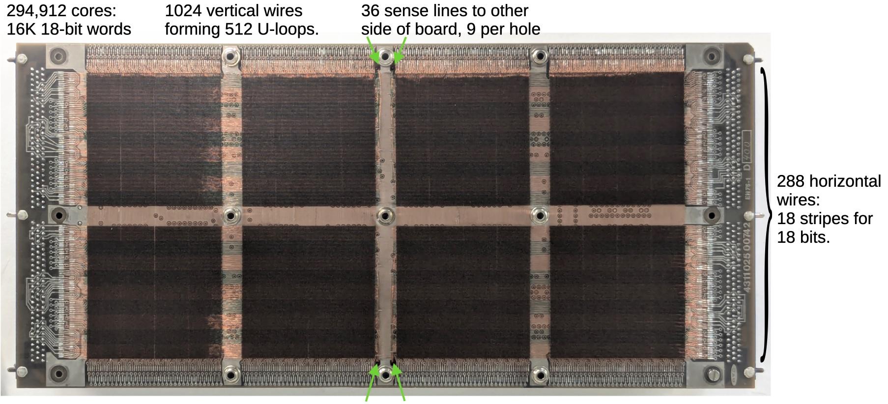

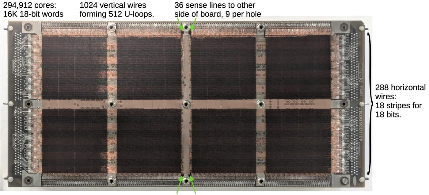

One of the core memory boards from the Spacelab computer.
The core memory board is arranged with 1024 vertical (Y) wires and 288 horizontal (X) wires, supporting 294,912 lithium ferrite cores. These very thin wires are soldered to tiny pads on the printed-circuit board. The board supports 18 bits, which is visible as 18 alternating stripes of green and copper because alternating sense lines have different colors. The board has 36 sense lines: the left and right halves of the board have independent sense lines to reduce noise, so the board has 36 sense lines for 18 bits. The sense wires pass through four holes in the board (green arrows) and are soldered on the back of the board.

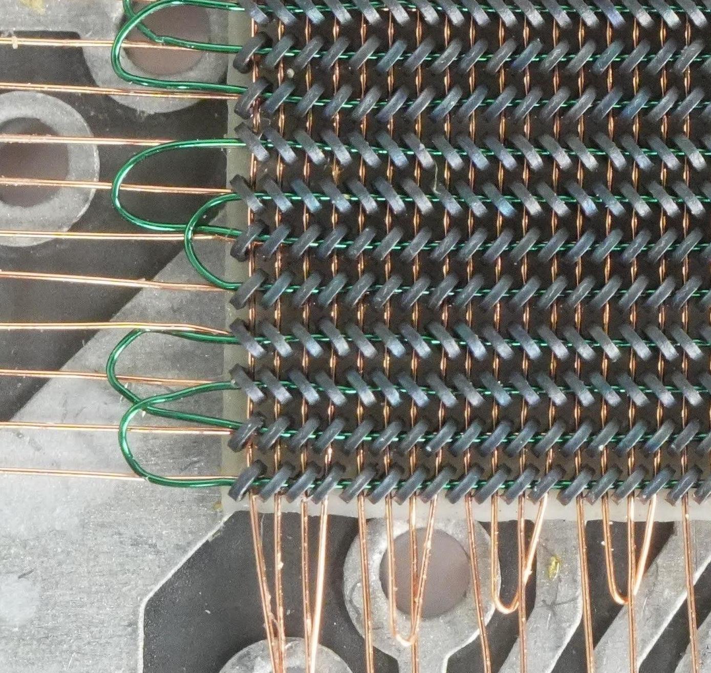

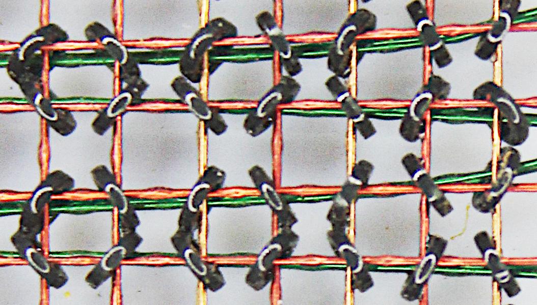

The photo below shows a close-up of the cores. Each core is approximately 32 mils (0.8mm) in diameter, the same as the IBM System/360 cores shown earlier. However, the cores are stacked much closer, with only a small gap between cores. The X and Y select lines are copper-colored, while the sense lines are green. (The wires are all enameled to prevent short circuits.) The sense wires loop around at the left, forming a single circuit through each bit section. Half the Y lines form loops at the bottom; the other half form loops at the top. Thus, each Y line passes through the plane twice in a U-shaped path, which will turn out to be important.
A close-up of the cores. I think that some rows tilt left and some tilt right to ensure that the sense lines keep the same polarity when they switch direction. Photo courtesy of CuriousMarc.

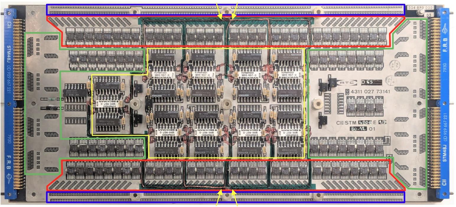

The other side of each circuit board holds the sense amplifiers and the diode matrix for the core plane. The diode chips are the square black packages, each containing 16 diodes for 8 core lines.6 In the red-outlined regions, one end of each vertical U-loop is connected to a diode chip; the lines of diagonal holes are the vias that pass each signal through the board. The other end of each vertical U-loop is connected to one of the blue board connectors on the side; these vias are in the blue-outlined regions. The horizontal lines use the diode chips and vias in the green regions. One end of each line is connected to a diode chip, while the other end is connected to a board connector through traces on the other side. Note that some vertical lines connect to the diode chips at the top of the board, while others connect at the bottom. Similarly, some horizontal lines connect at the left while others connect at the right.
The back side of the core plane board holds the diode matrices and sense amplifiers.
The central region (yellow) holds 18 sense amplifier chips, the black DIP integrated circuits, each containing two amplifiers.7 The white packages are resistor packages, holding multiple resistors to bias and terminate the sense amplifier lines. The wires from the sense amplifiers are connected as twisted pairs that are soldered to the board right next to the corresponding sense amplifier chips. Using twisted pairs for the whole distance prevents the wires from picking up electrical noise, which could overwhelm the tiny signals in the sense wires. The sense wires pass from one side of the board to the other through four holes in the board (yellow arrows), and then are glued down as they traverse a significant distance on the board. (It must have been difficult to manufacture the board without breaking the tiny, fragile wires.)

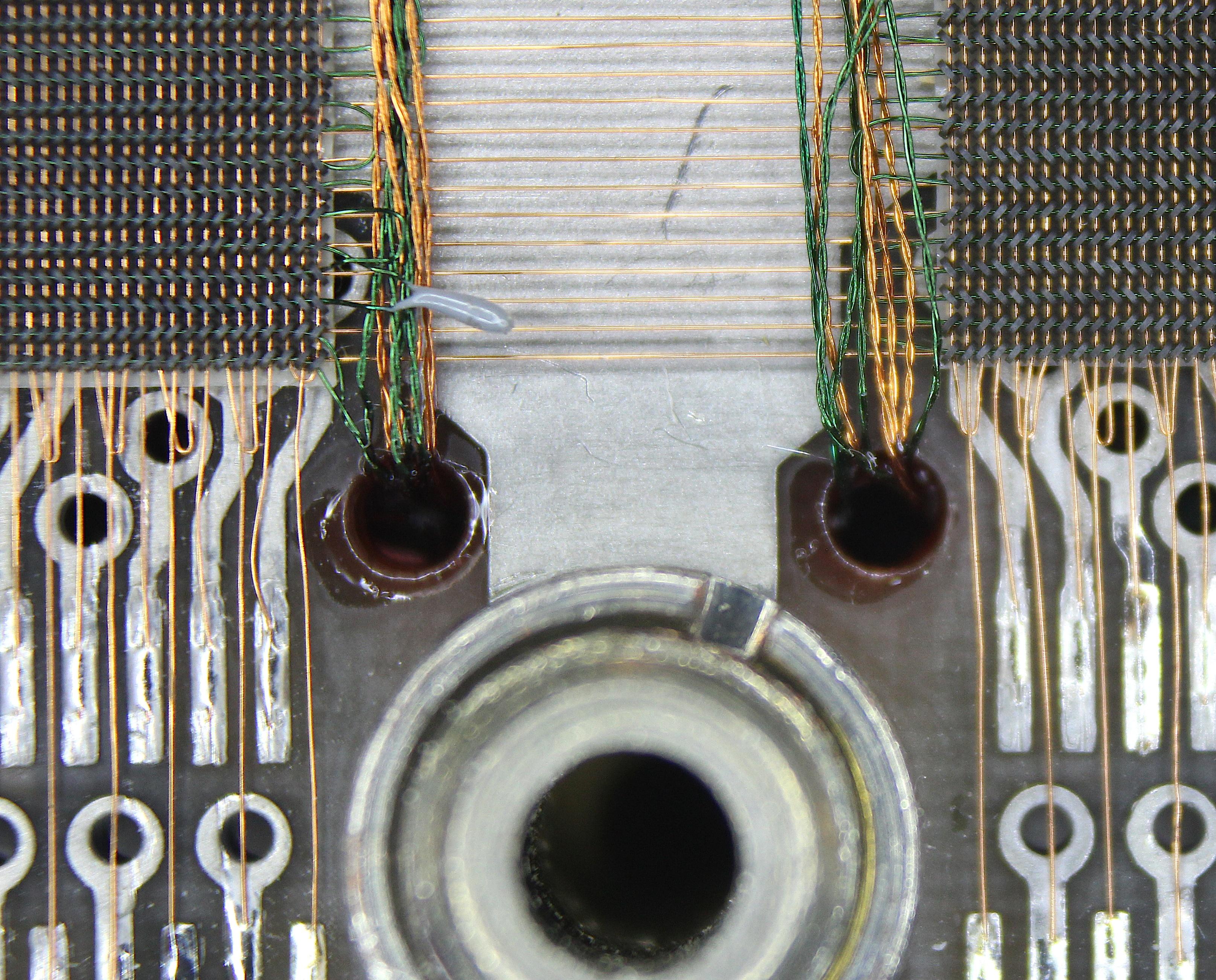

Each sense wire loop forms a twisted pair that is fed to the other side through a hole in the circuit board. Above the hole, you can see a gray blob where
sense wires were spliced for some reason.
Also note how alternating vertical wires are soldered to the
circuit board, with circular vias connected to the other side. The other vertical wires form loops.
are soldered to the circuit board
Each sense wire loop forms a twisted pair that is fed to the other side through a hole in the circuit board. Above the hole, you can see a gray blob where sense wires were spliced for some reason. Also note how alternating vertical wires are soldered to the circuit board, with circular vias connected to the other side. The other vertical wires form loops. are soldered to the circuit board

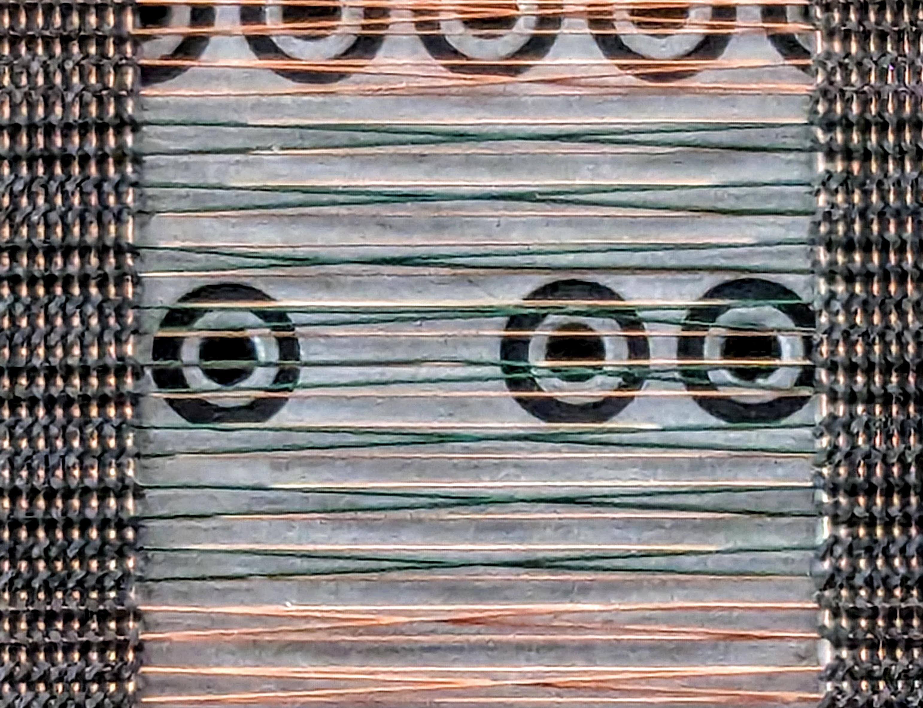

Detecting signals on the sense lines is tricky because the pulses are very small, a few millivolts. Because the sense lines run next to the X drive lines, they can easily pick up noise from the high-current pulses on the X lines. To minimize this noise, the sense lines cross each other between two plane sections, forming a "bow tie", as shown below. The result is that an X line runs next to the positive sense line for half the length and the negative sense line for the other half. Thus, the induced noise cancels out.
A close-up of the sense lines. The 16 sense lines in the middle are green, while the sense lines above and below (as well as the X lines) are copper. Note that the sense lines cross, while the X lines continue horizontally. The large circles are vias through the board.

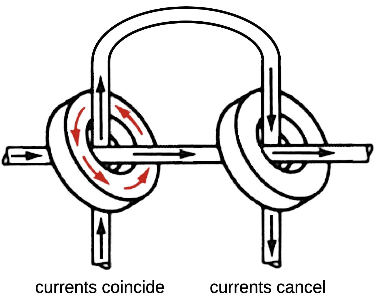

The core memory in the Spacelab computer used a different architecture from a typical core memory, improving performance by eliminating the inhibit line. This architecture was called a 2½D memory.8 If you're familiar with core memory, the lack of inhibit lines may seem puzzling: how do you write 1 to some bits and 0 to other bits? The trick is to have separate X driver circuitry for each bit.9 When writing data, the X lines are only energized for bits that receive a 1; the other lines are left unenergized, so the bits remain at 0. The disadvantage is that instead of one set of X driver circuits, you now need one set for each bit, a factor of 18 more for an 18-bit word. However, with the development of core drivers on integrated circuits, the cost of the additional driver circuitry became less significant.

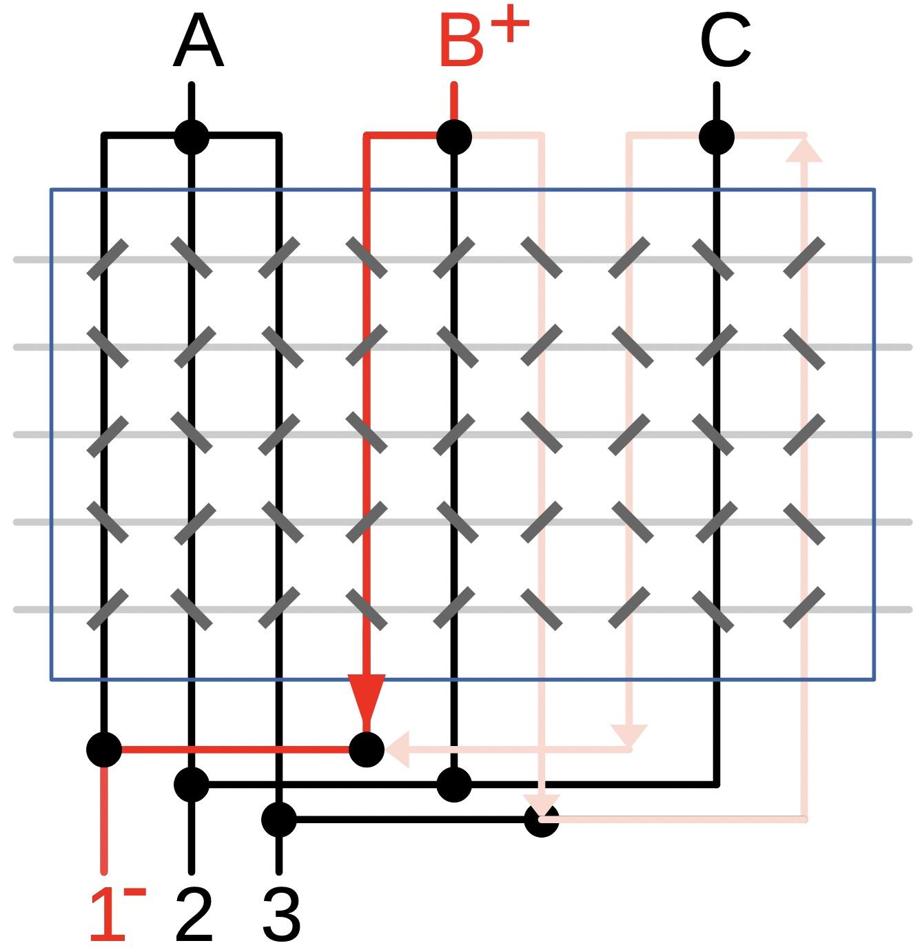

The memory system used an technique called phase reversal to cut the number of vertical drivers in half. Recall that pairs of vertical wires are joined by a U-connection. By driving the wire in a particular direction, the left side or the right side of the pair can be selected. For example, the drawing below shows how the two wires select the left core, but not the right core. In the left core, both currents go through the core in the same direction, inducing a magnetic field in the toroid.10 But in the right core, the two currents cancel out, so there is no magnetic field created. But if the current in the vertical loop is reversed, the right core will be selected, rather than the left core. The point is that instead of using two drivers for the vertical wires, one driver is used, reversing the current to select the left or right core.
Connecting pairs of vertical wires into a U-shaped loop lets each driver control twice as many cores.

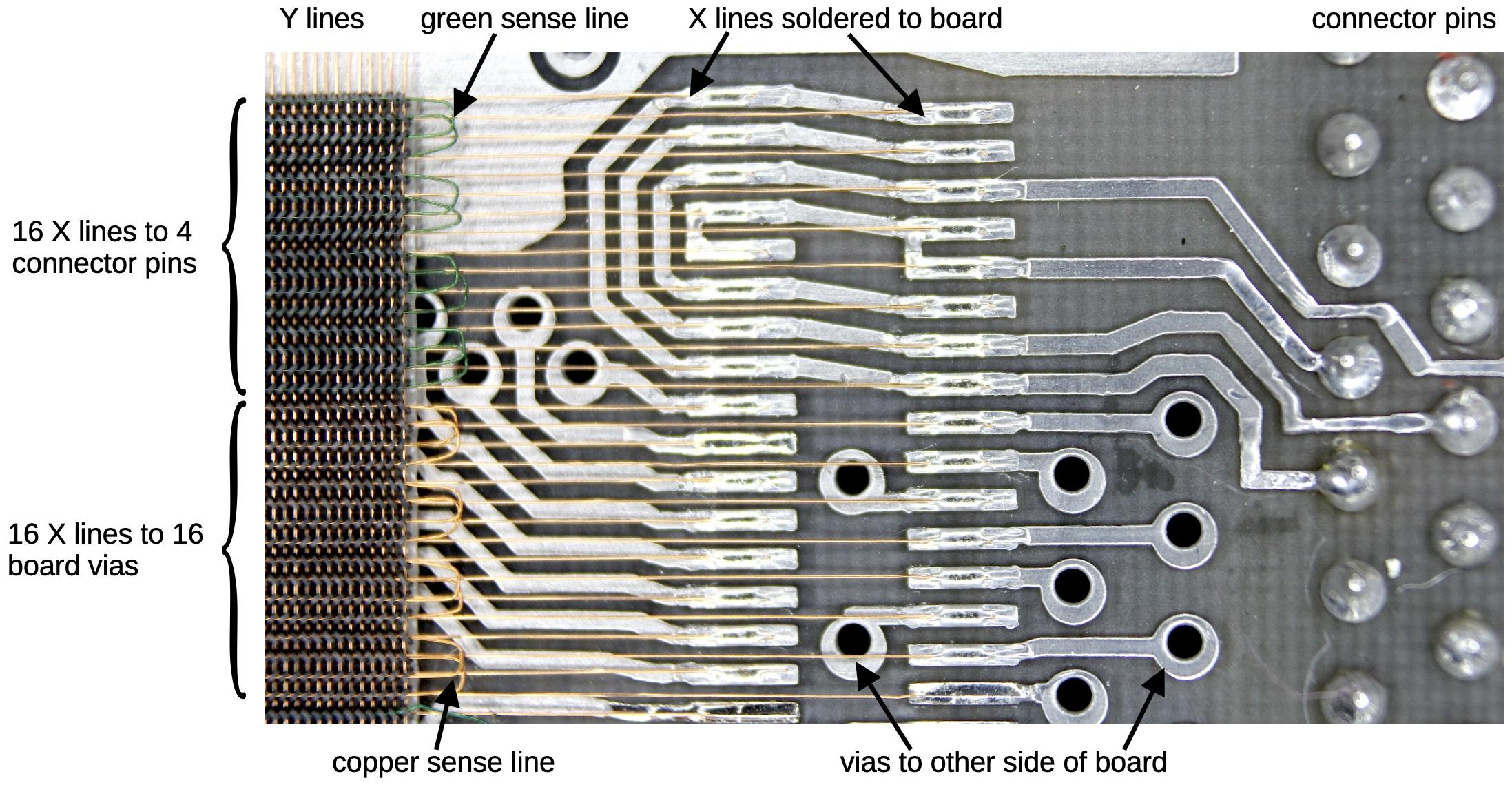

The diagram below shows the complex wiring for X drive wires. Each band of 16 wires corresponds to one bit in the 18-bit word, and has a separate sense wire. The top band of 16 X lines is connected to four contacts on the board connector; each contact is connected to four X lines through the curving PCB traces. The bottom band of 16 X lines is wired to diode modules on the other side of the board, connected through the round vias. (Each wire has the opposite connections—diode module or board connector—on the other end.)11 One group of four X wires is energized through the connector, while four wires are energized through the diode matrix, selecting one of the 16 X wires in the group.
The PCB wiring for the X lines.

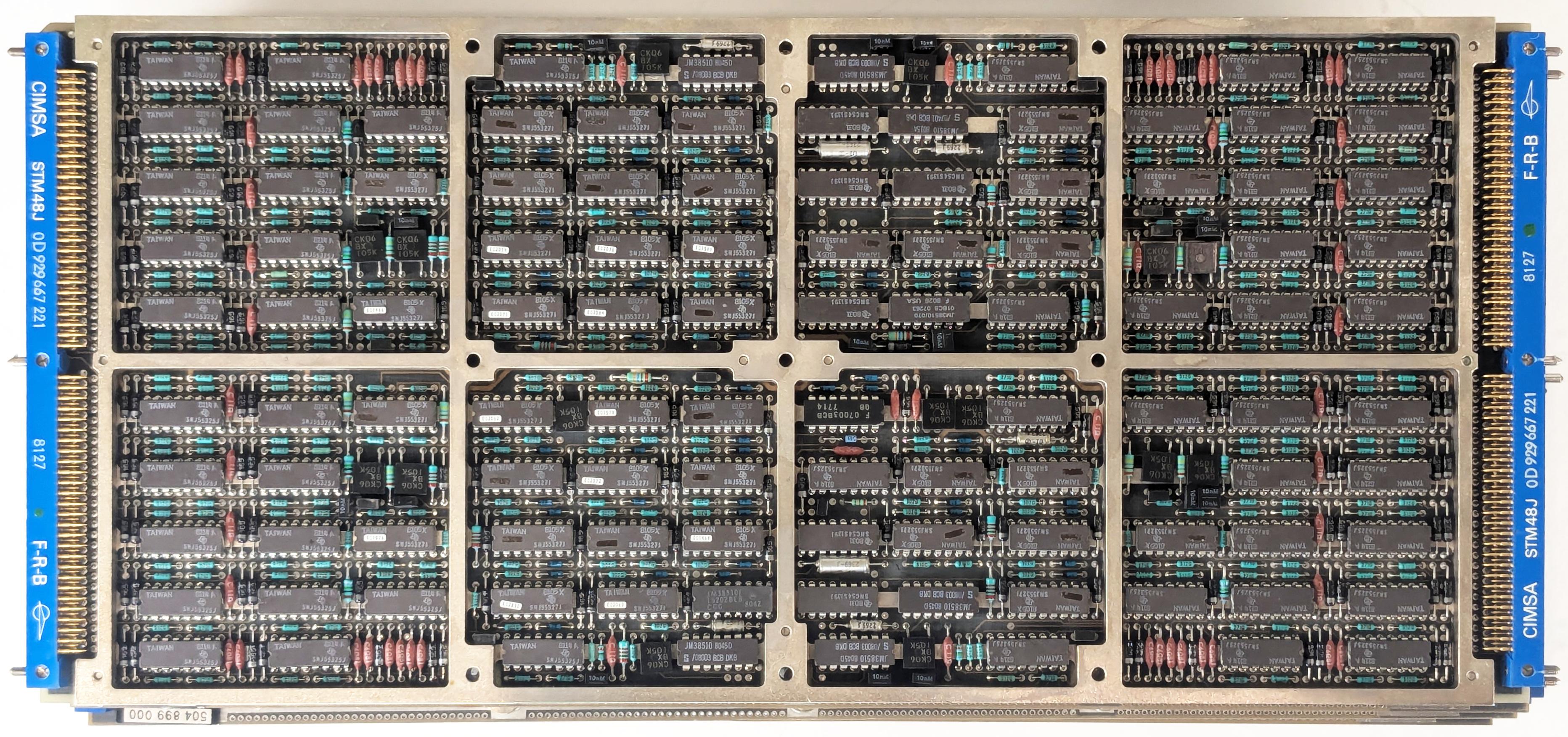

The memory stack has seven boards in total, arranged as a driver board, the four core planes, a second driver board, and an interface board. I haven't examined these boards in detail, but I'll give some preliminary information. The photo below shows one of the two driver boards. It provides the high-current pulses for the X and Y select lines. The board is crammed with specialized core memory driver chips12, along with a few logic chips to control the drivers. It has separate drivers for the two ends of the select lines, allowing the matrix selection described earlier.
One of the two memory driver boards. Click this image (or any other) for a larger version.
Since there are two driver boards and four core memory boards, at first I thought that each driver board controlled two core memory boards. The configuration turns out to be more complicated, with one more layer of matrix selections to cut the number of drivers in half. To simplify slightly, consider the X lines on a core board to have left ends and right ends, both of which must be energized to activate a line. For the left ends, the first driver board powers core boards 1 and 2, while the second driver board powers core boards 3 and 4. The right ends are shuffled: the first driver board powers core boards 1 and 3, while the second driver board powers core boards 2 and 4. Now, if the first driver board powers the left and right ends, core board 1 is the only one with both ends active. If the first driver board powers the left ends while the second board powers the right ends, core board 2 is activated. Similarly, core board 3 or 4 can be activated. The point is that since each set of drivers is connected to two core boards, two sets of drivers are required instead of four.

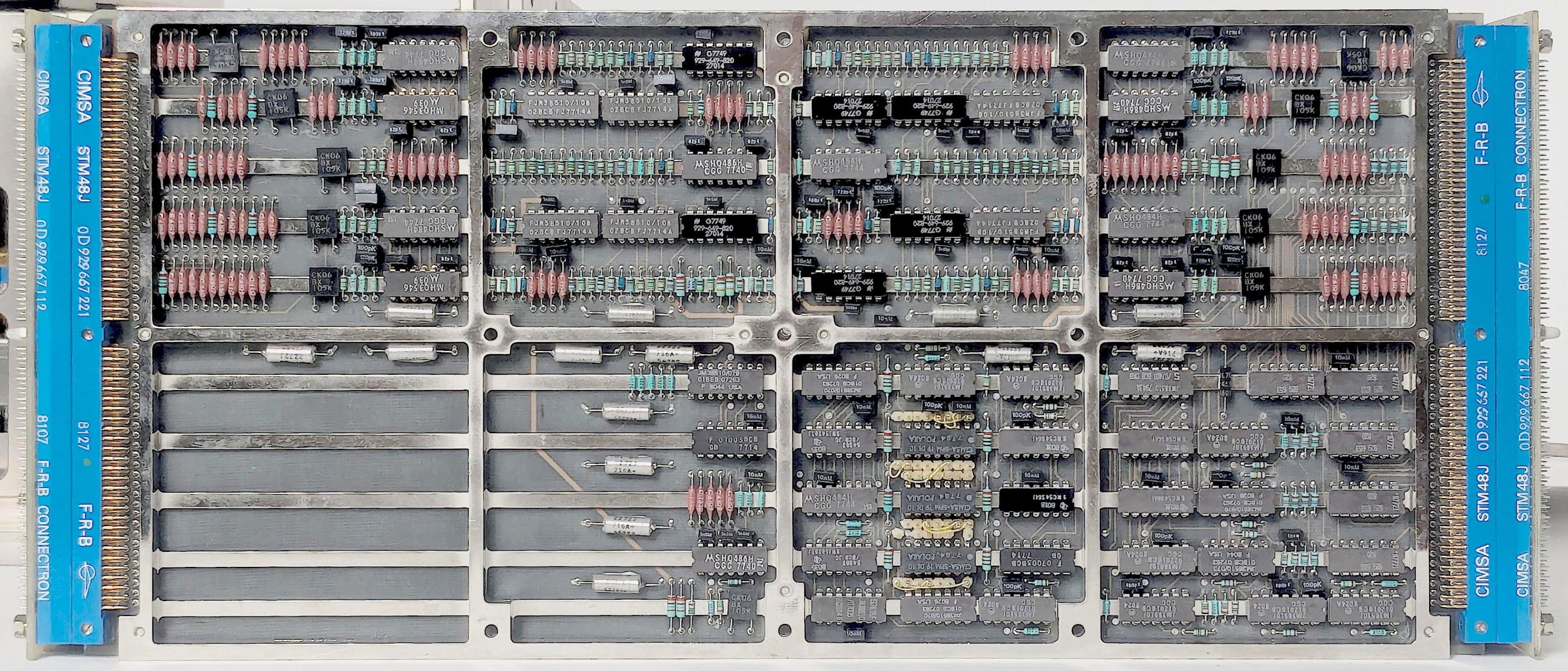

The final board is the interface to the rest of the computer. It has many transistor arrays in DIP packages, along with many resistors. It seems that the board uses discrete transistors to drive the bus, rather than using interface chips, which is unexpected. The board has some wire-wrapped jumpers in the lower center region, presumably for configuration.
The interface board has some unused space in the lower left.

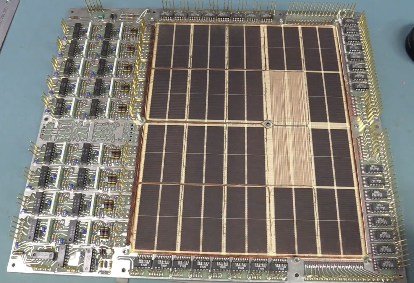

    On the ground, the Spacelab project used Mitra 125 S computers that were functionally identical to the Mitra 125 MS (details) computers that were used in space. A core memory board from a Mitra 125 S ground computer was described on EEVblog (video, video). The computers had identical architectures, but the 125 MS was militarized and designed for "severe environmental conditions" (details). The EEVblog memory board was manufactured by Ampex and has a different design from the board that I examined.
    The Mitra 125 S memory board, built by Ampex. Screenshot from EEVblog #668.

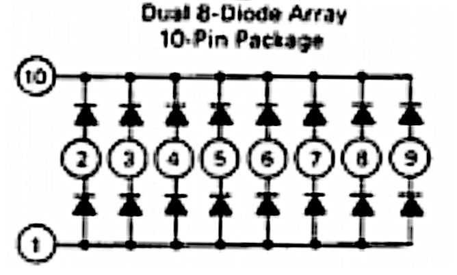

  6. The diode array chip is marked FSA2977 and contains 16 diodes, 8 common-cathode and 8-common anode. Pins 2 through 9 are connected to eight core wires. Pin 1 is driven high, or pin 10 is driven low, depending on the desired current direction. I couldn't find a datasheet for this part, but it appears to be similar to the Motorola MAD1103 Core-Driver Diode Array or the Silicon General SG5772F.
    A schematic matching the diode array, from the Motorola MC1103P datasheet.

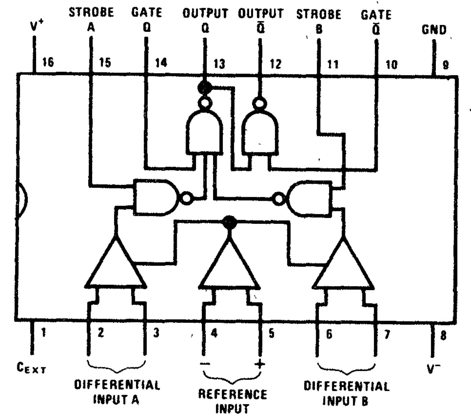

  7. The sense amplifiers are National Semiconductor DS5534 chips. Each IC contains two differential amplifiers, converting the tiny sense signals into logic signals. The strobe signals indicate when the amp should read a bit; the strobes come from the IC on the left side of the board, a 54150 dual 4-input NAND gate, 50Ω line driver.
    Diagram of the sense amplifier, from the National Interface Integrated Circuits Databook.

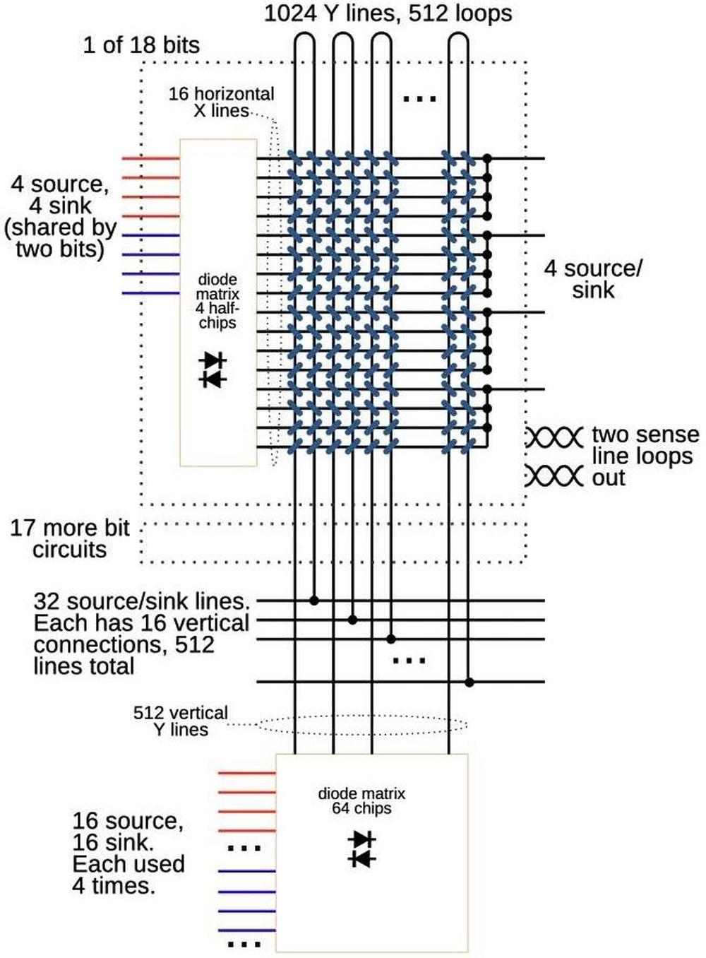

  11. For reference, this footnote describes the details of the core plane wiring, probably in more detail than anyone wants. For the Y lines, there are 1024 vertical lines, forming 512 U-shaped loops. Half of these are connected at the top, and half at the bottom. One end of each loop is wired directly to a connector on the side, while the other end connects to a diode matrix. The connectors provide 32 lines that can act as a source or a sink. Each of the 32 lines is connected to 16 vertical wires, for 512 vertical wires in total. Each quadrant of the board has 8 of the 32 lines, connected to a group of 8 vertical wires, a second group of 8 vertical wires, and so forth for 16 groups.
    For the diode connections, the connectors provide 16 source lines and 16 sink lines. Each diode chip has one source line and one sink line, feeding 8 vertical wires. Each source and sink line is connected to four diode chips, one in each quadrant in a mirrored pattern. Thus, the 16 source lines and 16 sink lines are connected to 64 diode chips, feeding 512 vertical loops. (Since each quadrant of the board has unique direct connections and the diode connections within a quadrant are unique, a unique core is selected. Specifically, 32 direct connections times 16 diode connections gives 512 combinations to select a vertical loop. The polarity selects which half of the loop is active, uniquely selecting one of 1024 vertical wires.)
    For the horizontal wiring, the 288 wires are grouped into 18 bands (one for each bit), with 16 wires per band. Each band has four direct signals from the connector. Each one is connected to four horizontal lines, 16 in total. (The visible PCB traces (shown earlier) connect the 16 wires to four connector pins (A,B,C,D) in the pattern AABBCCDDDDCCBBAA.)
    For the horizontal diode connections, the connector provides 4 source wires and 4 sink wires, which feed the 16 horizontal wires in a pattern 1234123412341234. By energizing the appropriate direct and diode wires on either side, one of the 16 lines is selected. One complication is that each diode chip has 8 outputs, but each source/sink goes to 4 wires. The solution is that each bit group uses half of four diode chips (4 outputs from each). Thus, the four source and sink wires are shared across two bit groups. This is not a problem for selection because the direct connections control whether the bit is active or not.
    The horizontal diodes are arranged asymmetrically. The left side has 8 diode chips at the top and 8 at the bottom, supporting 8 groups of 16 wires. The right side has 20 diode chips (4 additional in the middle), supporting 10 groups of 16 wires. Thus, all 18 bit groups are supported, with some asymmetry in the board layout.
    The left and right sides of the core plane have separate sense lines, so there are 36 sense lines in total. These go to the 18 dual sense amplifiers. Each sense amplifier has two outputs connected, a wired-OR to combine the left-hand data with the right-hand data, providing 18 bits of output to the connector.
    A diagram showing the topology of a core board. Click this image (or any other) for a larger version.)
    The diagram above summarizes the structure, showing one of the 18 bits. It omits the details of which connections are at the top, bottom, left, or right.

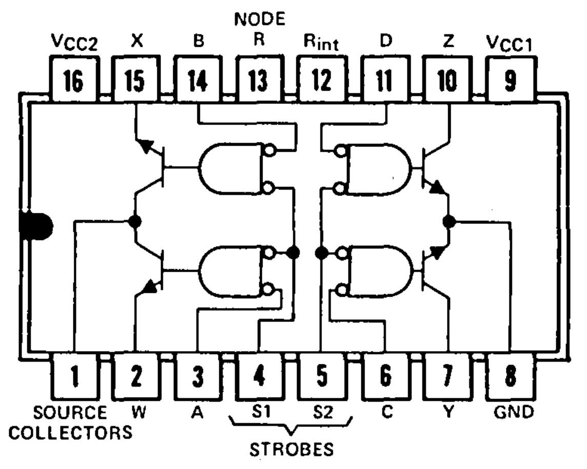

  12. Each driver board has 53 core driver chips of type SN55325.
    The SN55325 core driver chip, from the databook.
    Each chip has two 600 mA "sources" and two 600 mA "sinks" connected to two outputs. By energizing a source on one end of a line and a sink on the other end, the line can be driven in the desired direction. The driver board also has 39 driver chips of type SN55327. These chips are similar, except they can be used as either four sources or two sinks. These chips are used for the diode matrix inputs, where an input is either a source or a sink.
