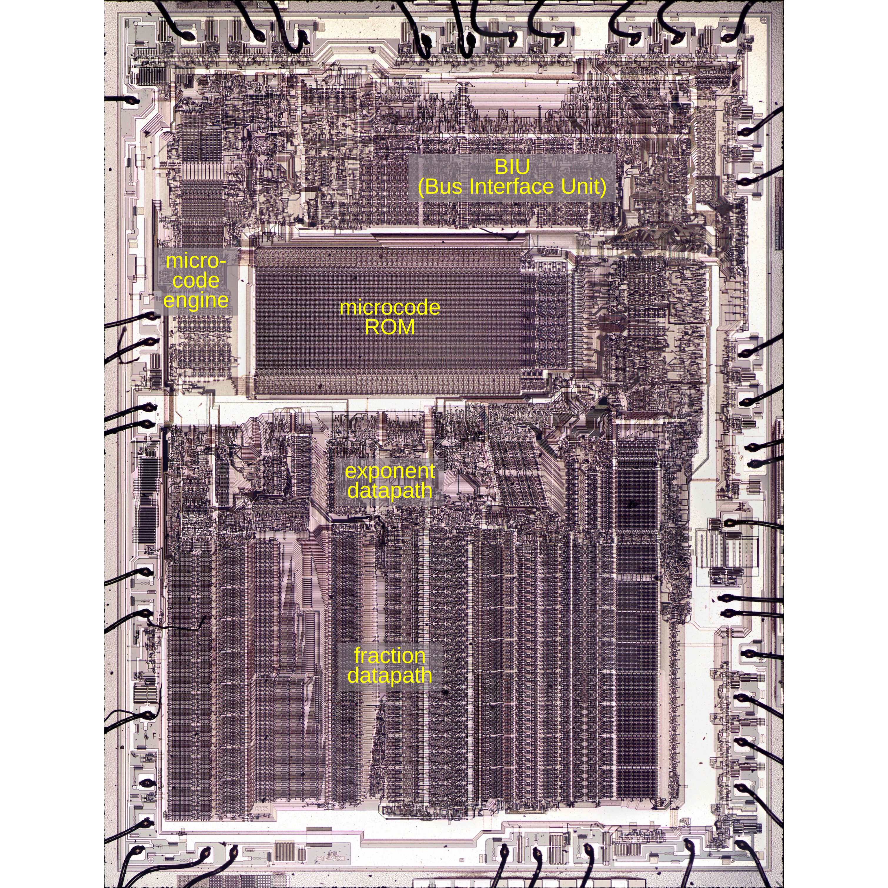

To explore the microcode, I opened up an 8087 chip and created a high-resolution image with a microscope. The large microcode ROM is in the center, holding the 1648 micro-instructions that control the chip. The microcode engine on the left steps through the microcode, handling jumps and subroutine calls. The bottom half of the chip is the "datapath", the circuitry that performs floating-point calculations; it is split into a 16-bit datapath for the number's exponent and a 64-bit datapath for the number's significand (also known as the fractional part).

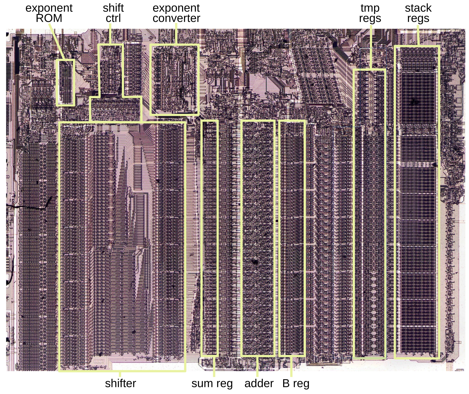

Zooming in on the bottom part of the chip shows the datapath circuitry; I've highlighted the relevant parts below.1 The exponent ROM holds various constants. The exponent converter is a specialized circuit that examines exponents, detects special values, and converts between exponent formats.2 The shifter is a large component; it allows a 64-bit3 value to be shifted left or right by arbitrary amounts. (I wrote about the 8087's shifter circuitry here.) The adder is the heart of the 8087's calculations; it is used in a loop for multiplication, division, and square roots. The B register holds one input to the adder, while multiple sources can provide the other input. The sum register holds the adder's output. The eight stack registers and the temporary registers hold floating-point numbers.
FSCALE.Details of the 8087

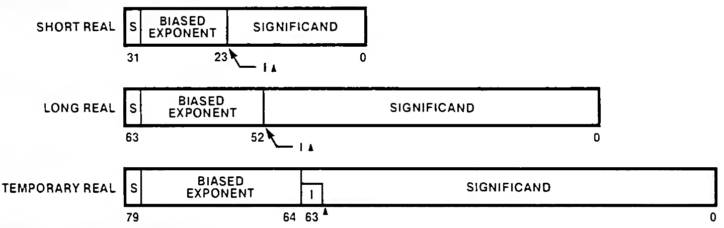

The 8087 supports a variety of data types: floating-point numbers of various sizes, integers, and binary-coded decimal.
But internally, everything is stored as an 80-bit floating-point number called a "temporary real"; for the rest of this article,
I'll only be considering temporary real values.

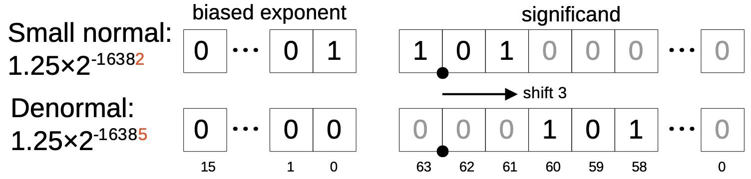

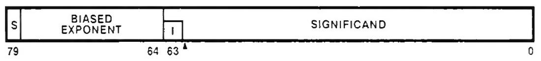

A number has three parts: the sign bit, the 15-bit exponent, and the 64-bit significand (the fractional part),
In most cases, a floating-point number is represented by sign × significand × 2exponent.
The significand is a 64-bit binary number of the form 1.bbb...:
a leading 1, followed by the binary point (the binary equivalent of the decimal point) and the rest of the bits.5
What makes floating-point numbers useful is that their scope covers the incredibly small to the astronomically large, thanks to the exponent, which
ranges from -16382 to 16383.
One important detail is that the exponent is stored with a "bias" of 16383 added to it. Thus, the stored exponent is always positive, even if the real
exponent is negative.6

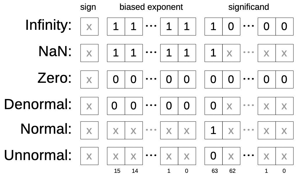

The 8087 supports several types of numbers that are represented as special cases with special exponents, as shown below. Zero and infinity have both positive and negative values. "Not a Number" (NaN) represents values that don't make sense, such as 0/0 or sqrt(-1); NaN has a large number of representations, not a single value. The 8087 also supports denormalized and unnormalized values, which are extremely small values where the significand doesn't have a leading 1.

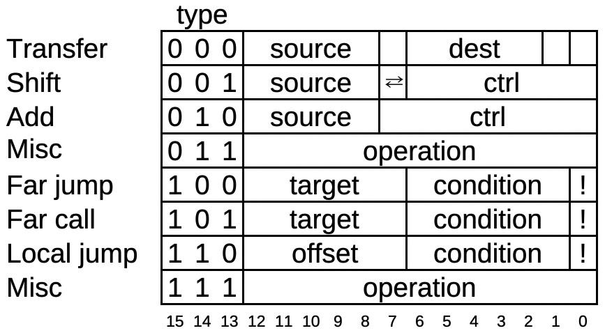

Executing an 8087 instruction can require hundreds of internal steps to compute the result. These steps are implemented in microcode with micro-instructions that specify each step of the algorithm. (Keep in mind the two levels of instructions: the assembly language instructions used by a programmer and the undocumented low-level micro-instructions inside the chip.) The microcode ROM holds the 1648 micro-instructions that implement the 8087's instruction set. I'm working with the Opcode Collective to reverse-engineer the micro-instructions and fully understand the microcode (link).
The 8087's micro-instructions are complicated, with many corner cases and ad hoc functions, but I'll provide a simplified overview. Each micro-instruction consists of 16 bits, as shown below. The first three bits specify the micro-instruction's type, which controls the meaning of the remaining bits. The first type is a transfer operation, which transfers data from one internal register to another. The two fields specify the source and destination. The three remaining bits are used for various special cases. Next is a shift operation, which uses the barrel shifter to shift a value left or right. The third type of micro-instruction controls the adder (which can also subtract). The miscellaneous instructions include stack pointer operations, tag modification, exceptions, and subroutine return. The far jump and far call micro-instructions perform a jump or subroutine call to a target micro-address in a fixed list. The condition field allows conditional jumps/calls/returns based on numerous conditions, while the last bit inverts the condition. A local jump is a relative jump to a nearby micro-instruction.

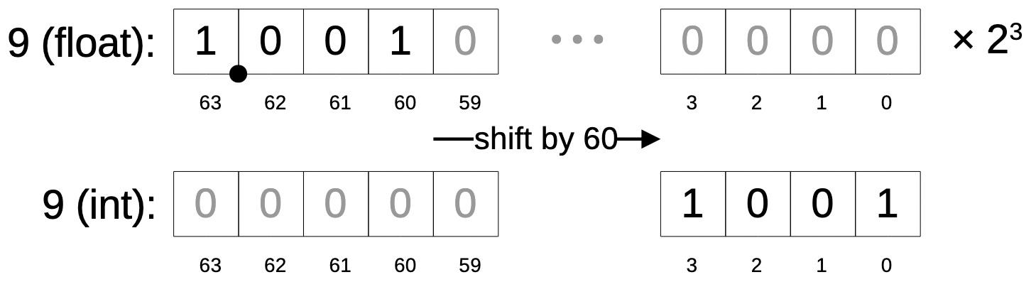

Continuing at #0763, the second argument is converted from a float to an integer, which takes a few steps.
For example, suppose the argument is 9, which in floating point is 1.001×23.
The significand bits 1000 are "left justified", but for an integer, these bits need to be "right justified" by shifting them to the right.
In general, if the exponent is n, the significand is shifted right by 63-n bits.
But recall that the exponent is biased by 16383. Thus, the significand must be shifted right by 63-(exp-16383) bits, that is 0x403e-exp bits.
(This explains the constant 0x403e earlier in the microcode.)

At #0763, the exponent of the second argument is moved to the B register, one of the inputs to the adder (completely different from tmpB).10
Next, the sign and exponent are moved to the exponent converter, a circuit that, among other things, tests for overflow.
Next, the constant 0x403e (selected back at #0754) is moved to the tmpC register.
At #0766, the adder is activated, subtracting the exponent from the constant.11
The adder puts the result into the sum register, and this value is copied to the shift count register, which controls the shifter.
This value indicates how many bits the second argument must be shifted to convert it to an integer.
At #0768, the shifter is activated to shift by the desired amount, using both the bit shift part and the byte shift part.
As with the adder, activating the shifter and reading the result are separate micro-instructions; the result is put into the B register.
The core part of the FSCALE instruction is finally performed at #0771, adding the second argument to the first argument's exponent.
The adder is activated to add the B register value (the scale) to the exponent, and the updated value is stored in tmpA's exponent.

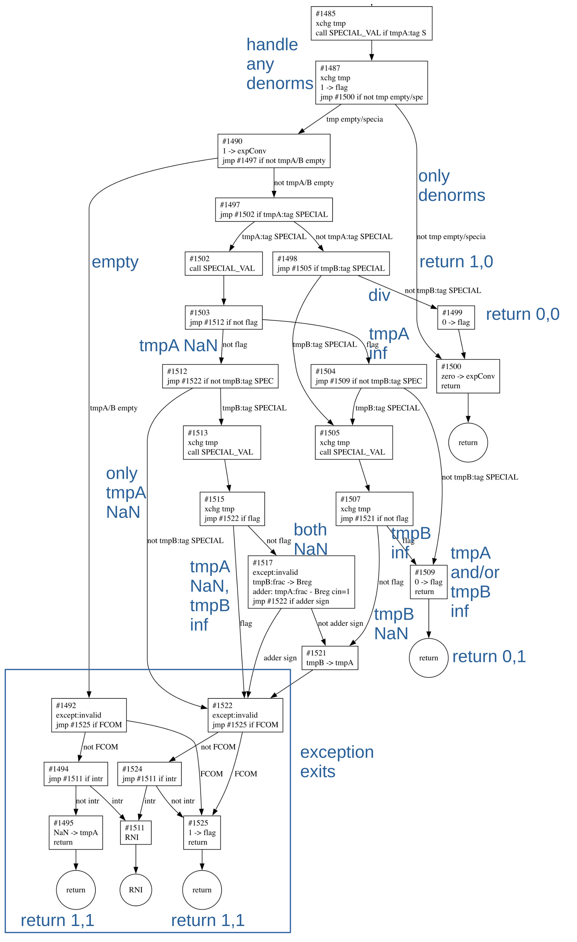

What happens if an argument accesses an empty stack location (i.e. stack underflow) or is a special value (infinity, denorm, NaN)?
These cases are handled by a micro-subroutine that I'll call SPECIAL_TMPS15 because it processes special values in tmpA and/or tmpB.
This subroutine is a general-purpose routine, used by basic arithmetic operations, FSCALE, FTST (test), and FPREM (partial remainder).
The control flow through SPECIAL_TMPS is rather convoluted since the code must prioritize issues if,
say, one argument is empty and the other is a denorm.
I'll just give a brief summary; see the footnote13 for details.
First, the subroutine converts any denorms to unnorms. Then it checks for access to empty stack locations, raising an exception or interrupt if so.
Then it checks the two arguments again. If either is NaN, an exception or interrupt is triggered. Otherwise, it returns a status indicating the type of arguments.
Unexpectedly, if both arguments are NaN, the code compares the two NaN values and returns the larger.
This behavior may seem very weird, but it's a documented feature.14
You might think that NaN is a single value, but it's actually an enormous family of values.
The idea was that the programmer could use different NaN values to signal where a problem occurs. For instance, you could put a different
NaN in each location of an uninitialized array, so you could tell which position was accessed.
For some reason, the designers of the 8087 decided that if you perform an operation with two different NaNs, the result is the larger one.
Thus, the microcode needs code that detects if both operands are NaN and computes the larger, using a subtraction for the comparison (#1518).

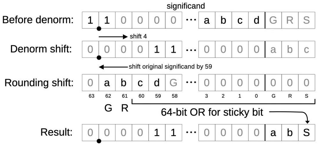

If you take a very large number and scale it larger, you can end up with overflow. If you take a very small number
and scale it smaller, you can end up with a denormalized number or underflow.
This will trigger an overflow, denorm, or underflow excaption, and an interrupt if unmasked.
Moreover, the 8087 supports four rounding modes:
round to nearest valid value, round down (toward -∞), round up (toward +∞), or round (chop) toward zero.
Depending on the rounding mode, an overflow can result in either ∞ or the largest possible floating-point number.
Similarly, an underflow can result in either zero or the smallest possible floating-point number.
And depending on the infinity mode (affine or projective), infinity can be either signed or unsigned.

One controversial feature of the 8087 is denormals, numbers that are smaller than "regular" floats. Recall that floating-point numbers have a significand with the first bit set to 1. But what happens if you hit the smallest possible exponent and want an even smaller number? The 8087 lets you break the rule that the significand starts with 1, producing smaller numbers known as denormalized numbers or denorms. Denorms significantly extend the range, providing numbers up to a factor of 263 smaller. However, denorms don't have as much precision since the upper bits are "wasted". Moreover, calculations with denorms can be substantially slower because special handling is required.
The diagram above shows a normal number with the minimum possible exponent (-16382, which is 1 after biasing). Dividing the number by 8 (or scaling by -3) creates a denorm since the exponent can't be reduced any further. Instead, the significand is shifted 3 bits to the right. The exponent is replaced with the special value 0, indicating that the number is a denorm.
In the 8087, denorms are created by a microcode subroutine that I'll call CREATE_DENORM;
it is used by many arithmetic operations, not just FSCALE.
This subroutine takes a normal number and a shift amount. By shifting the normal number (as in the example above), it creates a denormalized number.
The microcode (below) uses the exponent converter to check if the shift is 64 or more.
If so, there will be nothing left after the shift, so zero is returned.
Otherwise, the value is shifted to the right and the denorm is stored in the B register.
CREATE_DENORM (J20): #0522 sumreg:frac -> expConv Create denorm #0523 sumreg:frac -> shiftcount Number of bits to shift #0524 jmp #0528 if exponent[6:14] == 0 Jump if < 64 #0525 zero -> Breg No bits left, use zero #0526 shift tmpA:frac L 0 bytes, 0 bits Run through shifter? #0527 jmp #0532 #0528 shift tmpA:frac R count byte bit Shift right by the specified amount #0529 shift R -> Breg Result to Breg #0530 shift tmpA:frac L ~count byte bit Now shift back for sticky test #0531 NOP Wait for shifter #0532 rounding(h) -> Breg[grs] Store the three rounding bits in the Breg #0533 return
But why is the value then shifted to the left (#0530)?
The purpose of this is to get the rounding bits.
One of the principles of the 8087 is to get rounding correct, which is a lot harder than it seems.
In order to decide how to round up a number, you need to keep track of an impossibly large number of bits.
For instance, if you calculate 1 + 0 and round up, you get 1.
But if you calculate, say, 1 + 2-10000 and round up, you get a float a bit higher than 1.
The problem is how do you distinguish the two sums before rounding, without storing thousands of bits?
The trick is that the 8087 keeps three bits for use in rounding: the "guard" bit, the "round" bit, and the "sticky" bit. If you consider a "tail" of bits to the right of the significand, the guard bit is the most significant bit of the tail, followed by the round bit. The sticky bit is special: it is the OR of all the remaining bits in the tail, indicating if any of them are 1. Thus, 1 + 2-10000 has the sticky bit set, while 1 + 0 does not, so the two values can be rounded up differently. To generate the sticky bit, the 8087 uses a very large 64-bit NOR gate that tests the tail bits in parallel.
When a number is shifted to the right (e.g., when creating a denormal), bits are lost off the right.
To generate the rounding bits,
the value is shifted to the left, keeping all the tail bits that will eventually be discarded, and discarding the bits that will be in the final significand.
The top two bits go into the guard and round bits, while the remaining bits are ORed together to generate the sticky bit from the rest.17
The diagram above is an example of this process. Suppose the value is being shifted to the right by 4 bits. The tail bits abcd (or at least d) will get lost in the shift.
The rounding bits are computed by shifting the original significand to the right by 59 bits (the complement of 4). Bit 62 (a) becomes the new guard bit,
bit 61 (b) becomes the new round bit, and the OR of the remaining 64 bits becomes the new sticky bit. (Note that the old guard, round, and sticky bits get
ORed in too, so they aren't lost.)
Merging the significand from the first shift with the rounding bits from the second shift produces the desired result.

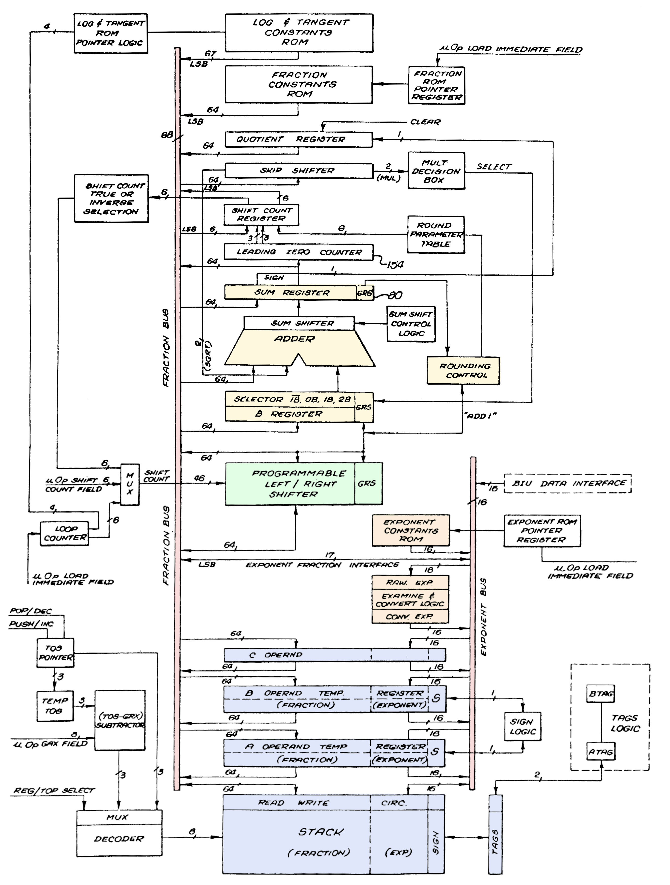

The 8087 patents provide some details on the hardware, but unfortunately not the microcode. The patent diagram below shows the architecture of the 8087; I've highlighted the relevant parts. The fraction bus and exponent bus are shown in red. The adder and associated registers are in yellow. (For subtraction, the B register selector selects the complement.) The shifter is in green. The exponent constant ROM and the exponent converter are in orange. The temporary registers and stack registers are in blue.
The architecture of the 8087. Based on the patent. Click this image (or any other) to magnify. -
The exponent converter is surprisingly complicated because the 8087 has three different formats for floating-point numbers with three different sizes of exponent fields (8 bits, 11 bits, and 15 bits). Moreover, the different sizes of exponents are stored with different biases. Thus, converting between different sizes of exponents is not trivial. The exponent converter also recognizes overflow and underflow for the different exponent sizes, as well as special values such as infinity and NaN. I plan to describe the exponent converter in more detail later. ↩
The significand in the 8087 is nominally 64 bits wide. However, the 8087 uses three extra low-order bits for rounding, called Guard, Round, and Sticky. These bits ensure that a value is always rounded in the right direction. Some parts of the datapath have additional bits for sign or overflow: the shifter is 68 bits wide, and the adder is 69 bits wide. For the most part, I'll ignore these extra bits and refer to the datapath as 64 bits wide. ↩
The external representations of floating-point numbers have an implied leading one, with only the bits after the binary point explicitly stored. This provides one additional bit of resolution "for free". The internal 80-bit representation, however, has an explicit leading one to simplify calculations. ↩
One reason that the exponents are biased is that to find the larger of two floating-point numbers, you can compare them lexicographically as signed integers, rather than needing to examine the exponents separately. ↩

The 8087 has separate buses for the exponent and the significand, and the adder is only connected to the significand bus, so how does the exponent get to the adder? The trick is that there is a 16-bit gateway between the exponent bus and the significand bus, so the exponent can be copied over. ↩
I described the 8087's adder here. In brief, subtraction is performed by inverting the B register's value when it is fed into the adder. The carry-in to the adder is set to 1, so this in effect performs a two's-complement subtraction. ↩

This flowchart shows the
SPECIAL_TMPSsubroutine. The structure of this routine is complicated because paths split off and rejoin. One tricky path is the code to determine if there are 0, 1, or 2 NaN values, and take the maximum NaN if there are two. Another complication is the exception exits, which raise an interrupt if the interrupt is not masked, but not for a comparison instruction. The two return values are returned throughflagandexpConv.A flowchart for the SPECIAL_TMPS subroutine. Click for a larger version.The actions of
SPECIAL_TMPSare summarized below. It returns status through theflagflip-flop and the exponent converter register (expConv). Its actions are:Input Result flag expConv empty NaN, exception 1 1 NaN (larger) NaN, exception 1 1 infinity infinity 0 1 denorm unnorm 1 0 div abnormal no change 0 0 (The last row signals an abnormal value during division computation; I'm still investigating this.) ↩

SPECIAL_VALhandles denormalized values, infinity, and NaN. (This subroutine is primarily used bySPECIAL_TMPS, but is also used byFRNDINT(round to integer) andFSQRT.) First, the subroutine looks at the exponent oftmpA; if the exponent is zero, the value is denormalized. (The value could also be zero, but that was handled earlier.) If so, thedenormexception is set. Comparison instructions such asFCOMhandle denorms differently, but I'll ignore that for now. The code at#1576tests if thedenormtriggered an interrupt; if so, the instruction ends with the interrupt. If the interrupt was masked, the code converts the denorm to an unnorm by changing the tag tonormand changing the exponent to 1 (which corresponds to the very negative, smallest valid value because of the exponent bias). The result of the subroutine is returned through a special flag flip-flop.SPECIAL_VAL (J12): #1572 tmpA:exp -> sumreg:frac Handle special value #1573 jmp #1581 if not Sum register is zero Test exp for denorm #1574 except:denorm #1575 jmp #1577 if compare instruction No exception for comparison #1576 jmp #1571 if DE (denormalized) interrupt RNI if exception #1577 norm -> tmpA tag Handle denorm: tag empty? or valid? #1578 1 -> tmpA:exp Change to unnorm #1579 0 -> flag Clear flag #1580 return #1581 shift tmpA:frac L 0 bytes, 1 bits Shift to check if infinity vs NaN #1582 shift L -> sumreg:frac #1583 jmp #1579 if not Sum register is zero Clear flag for NaN #1584 1 -> flag Set flag for infinity #1585 return
At
#1581, the code checks if the value is infinity or NaN. Interestingly, this test isn't done directly, but by manipulating the value with the shifter. Recall that infinity has a significand of10...00, while NaN has at least one additional1bit. The code shifts the significand one bit to the left; a zero result indicates infinity, while a nonzero result indicates NaN. As before, the result is returned in theflagflip-flop. ↩ -
