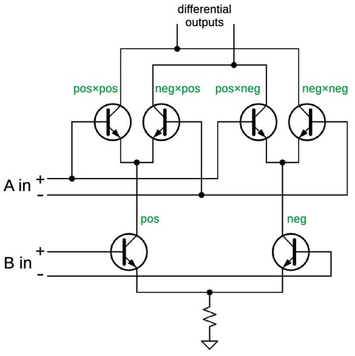

The Gilbert cell multiplier
But how do you multiply two signals? This is accomplished with a circuit called a Gilbert cell.14 This circuit takes two differential inputs, multiplies them, and produces a differential output. The Gilbert cell is a bit tricky to understand,15 but you can think of it as a stack of differential amplifiers, with the current directed along one of four paths, depending on which transistors turn on. For instance, if the A and B inputs are both positive, current will flow through the leftmost transistor, labeled "pos×pos". Likewise, if the A and B inputs are both negative, current flows through the rightmost transistor, labeled "neg×neg". The outputs from both transistors are connected, so both cases produce a positive output. Conversely, if one input is positive and the other is negative, current flows through one of the middle transistors, producing a negative output. Since the multiplier handles all four cases of positive and negative inputs, it is called a "four-quadrant" multiplier.
Schematic of a Gilbert cell.
Although the Gilbert cell is an uncommon circuit in general, the TDA7000 uses it in multiple places. The first mixer implements the superheterodyning. A second mixer provides the FM demodulation, multiplying signals in the quadrature detector described earlier. The TDA7000 also uses a mixer for its correlator, which determines if the chip is tuned to a station or not.16 Finally, a Gilbert cell switches the audio off when the radio is not properly tuned. On the die, the Gilbert cell has a nice symmetry that reflects the schematic.
This is the Gilbert cell for the first mixer. It has capacitors on either side.

  14. A while ago, I wrote about the Rockwell RC4200 analog multiplier chip. It uses a completely different technique from the Gilbert cell, essentially adding logarithms to perform multiplication.
  15. For a detailed explanation of the Gilbert cell, see Gilbert cell mixers
